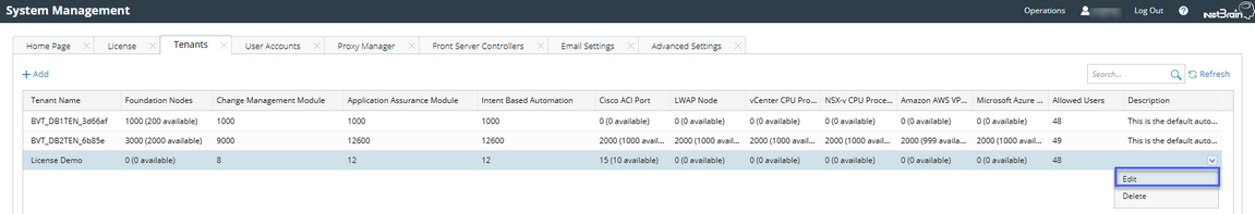

Allocating ACI Licenses to an Existing Tenant and Domain
2.Select the Tenants tab, and select Edit from the drop-down list of the desired existing tenant.
3.Allocate the desired number of ACI ports to the tenant.
4.Click OK to submit.
