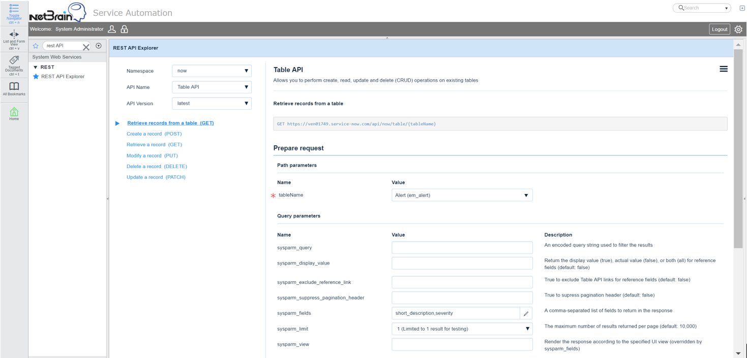

ServiceNow offers a friendly API Browser for you to browse and test its API calls.
1.Log into a ServiceNow instance and navigate to REST API Browser (search for Rest API to find the link to API browser).
In this case, Table API will be used to retrieve records from a table with the URL https://{ServiceNow InstanceURL}/api/now/table/{tableName}. The table name for Alert records is em_alert and so the full URL to get records for alerts from ServiceNow will be https://{ServiceNow InstanceURL}/api/now/table/em_alert.
2.Set the query parameters for this table. To make the sample code simple, you can keep the most parameters as default and select sysparm_fields as short_description, severity, node and add an additional parameter node as the device name.

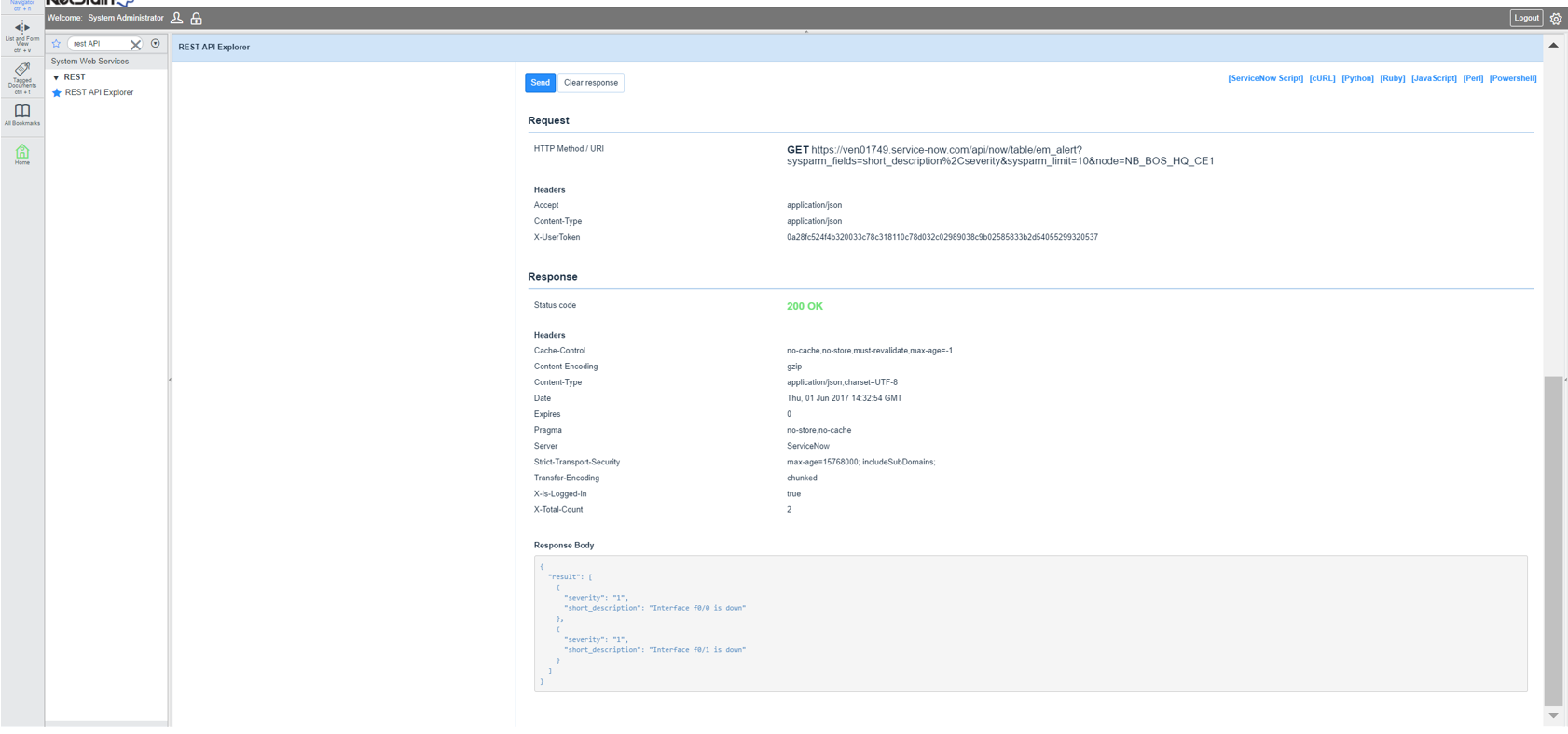

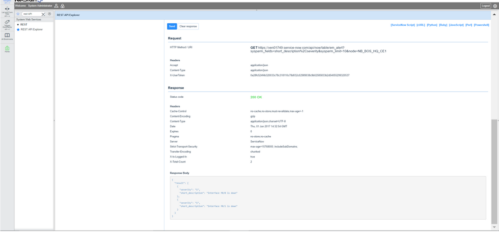

Example: A response from ServiceNow.
3.Put these together in Python codes:
# Set the request parameters.
  #URL for Table API: urlprefix is  https://<ServiceNowUrl>/api/now/table
          url_table = '/'.join([self._urlprefix, 'em_alert'])
        #query parameters
        deviceName = params['deviceName']
        urlparams = {
            "sysparm_fields":"short_description,severity,node",
            "node":deviceName}
                                     # Set proper headers
        headers = {"Content-Type""application/json",
                    "Accept""application/json"}
        #authentication
        auth =(self._usr, self._pwd)

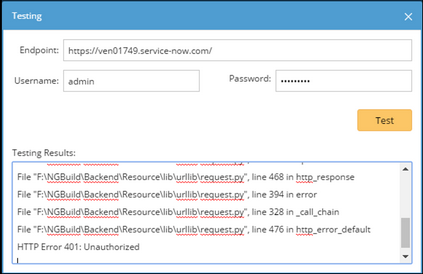

After finishing this function, you can modify the _test function as follows to debug it:
def _test(self):
        paras = {"deviceName""BIGIP1"}
        alerts = self.getAlertsByDev(paras)
        return alerts
The _test function should always return an object type of dictionary. If the function call succeeds, the returned value will be printed out. Otherwise, the error message (with the call stack) will be displayed in the Testing dialog.
