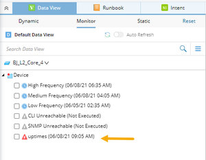

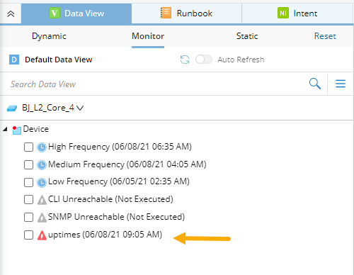

All the enabled device alert Flash Probes are placed under the Device folder.
The Flash Probe will present the latest detection results with different color codes:
Icon |
Meaning |
A flash alert has been generated. |
No flash alert has been generated. |
The results are unknown, either the probe was not executed or there’s some error happened during execution. |

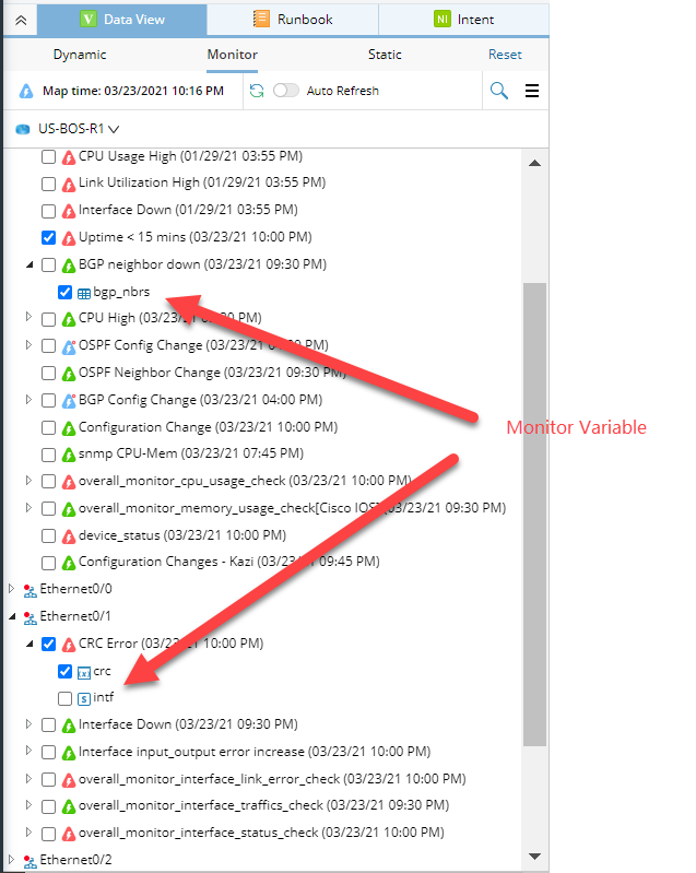

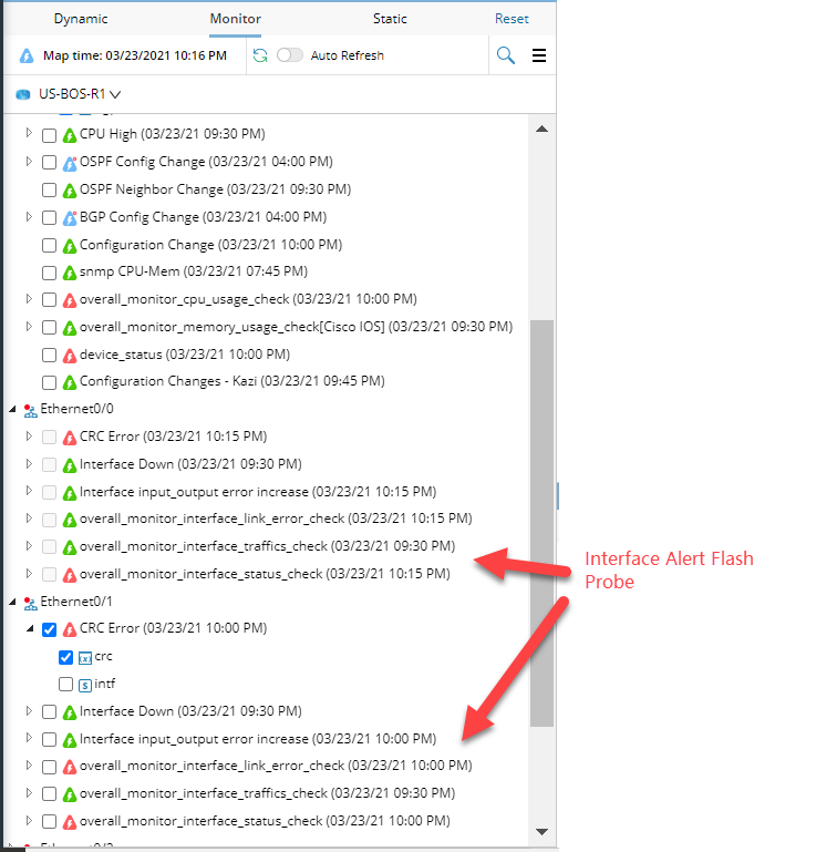

All the enabled interface alert Flash Probes are placed under the respective interfaces defined within this Flash Probe.
The Flash Probe will present the latest detection results for each interface with different color codes:
Icon |
Meaning |
The alerts are generated by the Flash Probe. |
The alerts are not generated by the Flash Probe. |
The Flash Probe has encountered execution error. |
The Flash Probe has not been executed yet. |

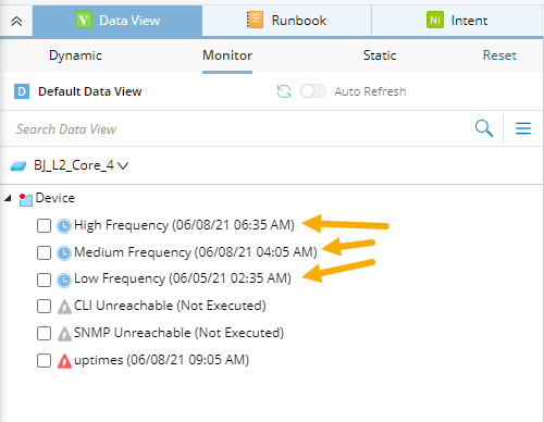

All the enabled timer Flash Probes are placed under the Device folder:
The Monitoring Variables are organized and placed under the associated Flash Probes. If the same variable is associated with multiple Flash Probes, this variable will appear under each Flash Probe. If the Monitoring Variable is defined within the
interface alert Flash Probe, it will appear under each interface and the associated Flash Probe.

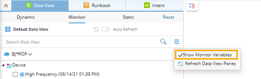

Selecting Show Monitor Variables option so all the Monitoring Variables will be displayed in Monitor Data View Pane.
