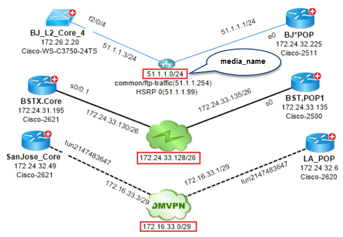

MapAutoLayout ([layout_style, map_name, page_name]) |
Specify the layout style of a map. ▪layout_style — the style of map layout. By default, the value is LayoutStyle.Symmetric. See Auto Layout Style for more details. ▪map_name — the name of a map. The default value is null, which means that the map that the current Qapp runs on. ▪page_name — the name of the map page. The default value is null, which means that the map page that the current Qapp runs on. |
MapAutoLink([topology_type, map_name, page_name]) |
Auto link the devices on a map page. ▪topology_type — Specify to use which topology type to connect. The default value is IPv4 L3 topology. The topology type includes: oL2_Topo_Type — Layer 2 topology. oL3_Topo_Type — IPv4 Layer 3 topology. oIpv6_L3_Topo_Type — IPv6 L3 Topology. oVPN_Topo_Type — L3 VPN Tunnel topology. ▪map_name — the name of a map. The default value is null, which means that the map that the current Qapp runs on. ▪page_name — the name of the map page. The default value is null, which means that the map page that the current Qapp runs on. |

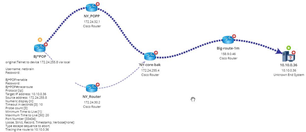

DrawTraceRouteHops([{'ips':[]}]) |
Draw the traceroute result hop by hop on a map based on the IP address of each hop. The parameter of this API is a sequential hop list and you need to enter all hops based on the sequence that a hop is drawn. ips — The IP address of a hop. Input all load balance IP addresses in the ips field if a hop contains load balance. For example, 'ips':["IP2","IP3"], IP2 and IP3 are loading-balancing hop. |

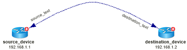

HighlightNeighbor(source_device_name, destination_device_name, legend, source_text, destination_text[, color, two_way, line_style, thickness, map_name, page_name]) |
Highlight the specified neighbor of a device on a map. ▪source_device_name — the hostname of the source device. ▪destination_device_name — the hostname of the neighbor device. ▪legend — the legend name. ▪source_text — any strings about the source device. ▪destination_text — any strings about the neighbor device. ▪color — the color of the highlighted interface. The default value is color. random. See color for more details. ▪two_way — whether to draw a line with two directions. The value type is bool and the default value is false. ▪line_style — the style of the line. See line style for more details. ▪thickness — the thickness of the link. The default value is 2. ▪map_name — the name of a map. The default value is null, which means that the map that the current Qapp runs on. ▪page_name — the name of the map page. The default value is null, which means that the map page that the current Qapp runs on. |
