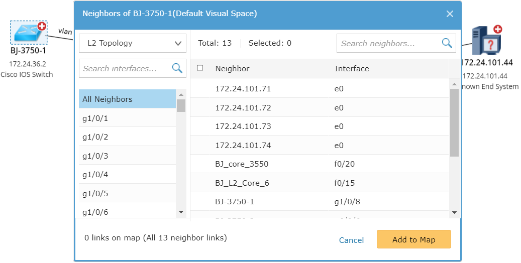

3.Click the
icon attached to the device to extend layer 2 neighbors as follows.
Tip: The bus icon
is a medium used to simulate a layer 2 port on a map when the port is connected with more than 2 ports or devices.
