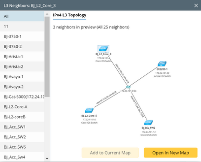

3.Click the X L3 Neighbors hyperlink (for instance, 25 L3 Neighbors). A preview map containing the searched device (for instance, BJ_L2_Core_3) and its neighbors are displayed.
4.To display the preview map on the existing map, click Add to Current Map; To display the preview map on a new map, click Open in New Map.
