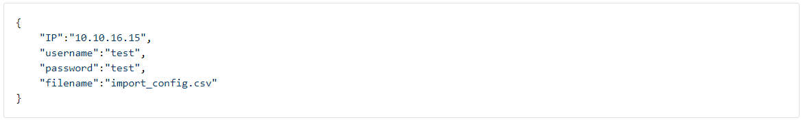

3.In a discovery task, add this plugin and define it as follows:
1)Select Before executing discovery task as the execution point.
2)Define the input. In the Input filed, enter the information to access the FTP server and the name of the CSV/Excel file.
This plugin will be executed when the system runs the discovery task next time.

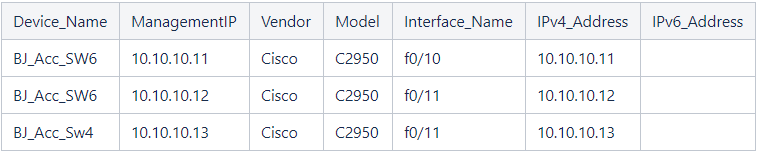

1.In a network shared directory (an FTP server in this case), prepare a CSV/Excel file to populate the information of the end systems that you want to add. The sample format of the CSV file is as follows:
   The parameters in the CSV file are described in the table below:
Parameter
Description
Device_Name*required
The name of the end system that you will import.
ManagementIP*required
The management IP of the device that you will import.
Vendor
The vendor information of the device that you will import.
Model
The model of the device that you will import.
Interface_Name
The interface name of the device that you will import.
IPv4_Address
The interface IPv4 address of the device that you will import.
IPv6_Address
The interface IPv6 address of the device that you will import.

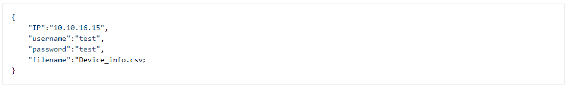

2.In a discovery task, add this plugin and define it as follows:
2)Define the input. In the Input field, enter the information to access the FTP server and the name of the CSV/Excel file.

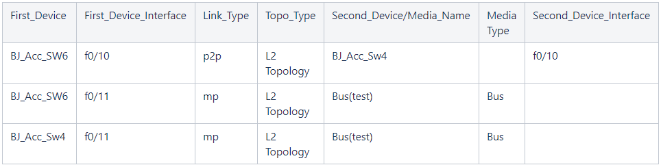

Parameter
Description
First_Device*required
One of the two devices that you want to stitch the topology between them.
First_Device_Interface*required
The interface of the device that you will stitch topology.
Link_Type
The type of link that you want to add between two device interfaces. There are two link types:
p2p: means point-to-point connection.
mp: means point-to-multipoint connection.
Topo_Type
The topology type of the link between two device interfaces. There are the following topology types:
Second_Device/Media_Name
The device or media name that the first device connects to. When the link type is mp, this field is required.
Media Type
The type of the media, including LAN, BUS, VPLS and L2 Overlay.  When the link type is mp, this field is required.
Second_Device_Interface
The device interface that the first device interface connects to. When the link type is p2p, this field is required.

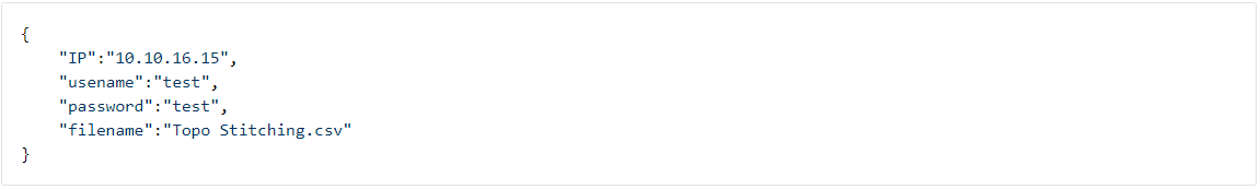

2.In a benchmark task, add this plugin and define it as follows:
1)Select After building L3 topology as the execution point.
This plugin will be executed when the system runs the benchmark task next time.
