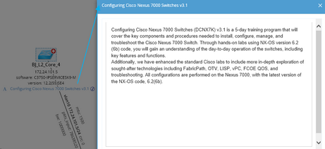

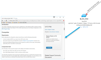

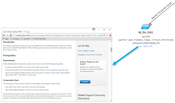

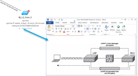

You can manually add, edit, and remove data units in data views. Many types of data units can be added to data views, such as hyperlinks, rich texts, and attachments.
Example: Add an STP table to the Static Data View SDV1.

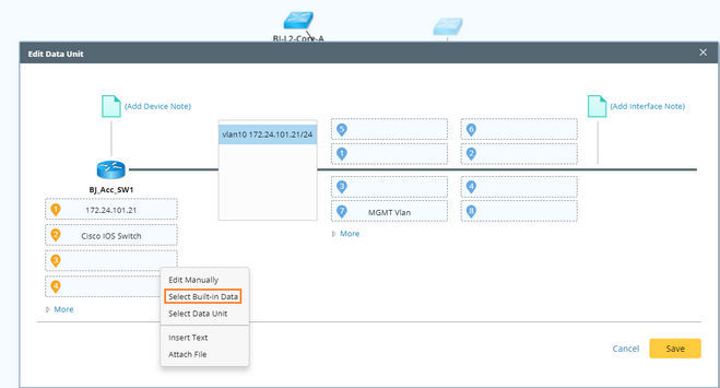

3.In the editing mode, click the device BJ-Acc-SW1. The existing device data units are displayed in the corresponding positions.
1)Point to a blank device position and click the
icon to select Select Built-in Data from the drop-down menu.
Tip: If all the reserved positions are occupied, you can add data units on overflowed positions.
Tip: For more details about the drop-down menu, refer to the following table .

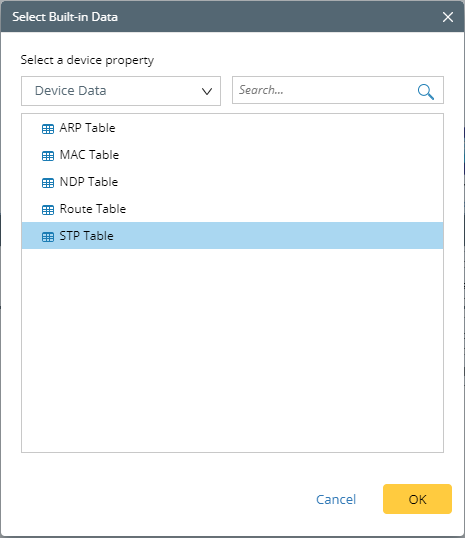

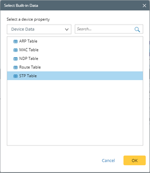

2)Select Device Data from the drop-down list and select STP Table from the available table types. Click OK.
Tip: The manually edited data units will be automatically locked.

Attach File |
