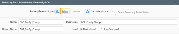

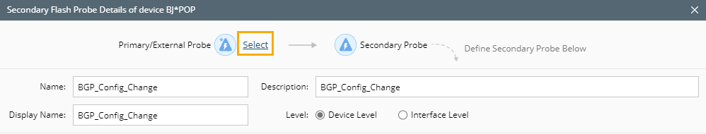

To specify the desired primary flash probe(s) to trigger the secondary flash probe of the same device, simply select one or more primary flash probes from the Select section in Secondary Flash Probe Details.

1.Specify the desired primary flash probe(s) to trigger the secondary flash probe.

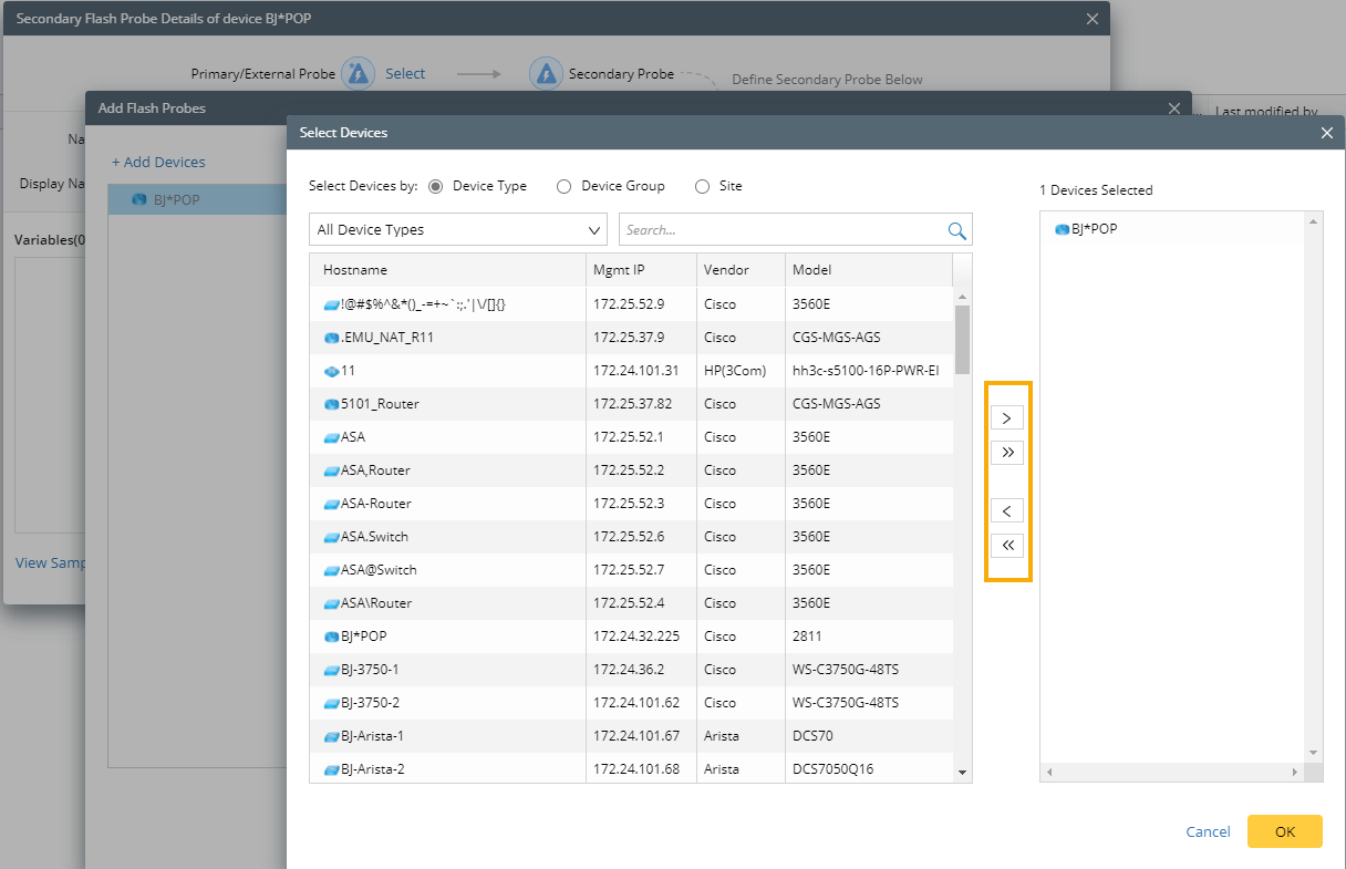

3.In the Select Devices window,
1)Click on the desired device, and click to add it to the Devices Selected list. You can click to deselect it. To add/remove all the devices to/from the Device Selected list , click or.
2)Click OK.

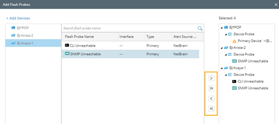

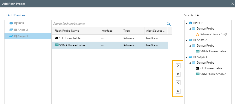

4.In the Add Flash Probes window,
1)Click on the desired flash probe, and click to add it to the Selected list. You can click to deselect it. To add/remove all the devices to/from the Selected list , click or.
2)Click OK.
