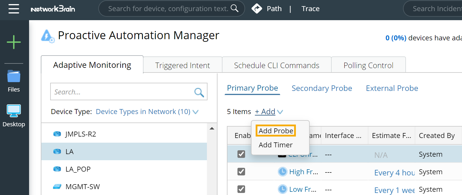

1.Click on the task bar and select Proactive Automation Manager from the drop-down menu.
2.From the Adaptive Monitoring tab and on Primary Probe pane, select the target device and click +Add. From the drop-down list, select Add Probe.
