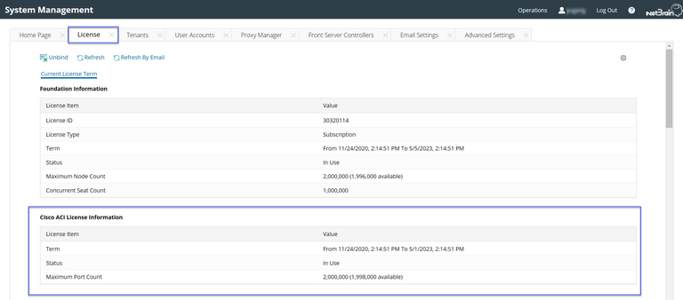

Note: Before continuing with the following steps, make sure your ACI license has been activated. Here is an example:

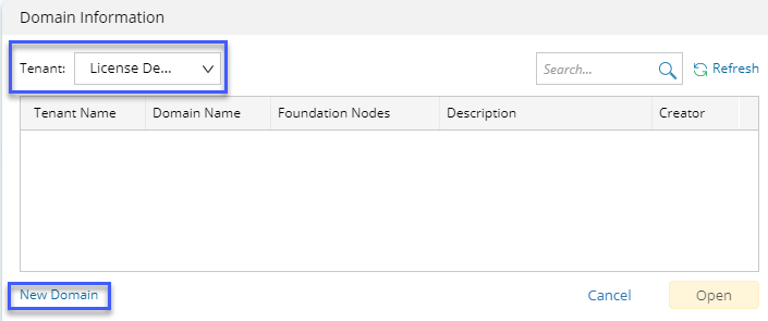

6.Select the tenant you created from the quick access toolbar, and click New Domain.
7.Specify a domain name and allocate  the desired number of ACI ports to the domain.
8.Click Finish.

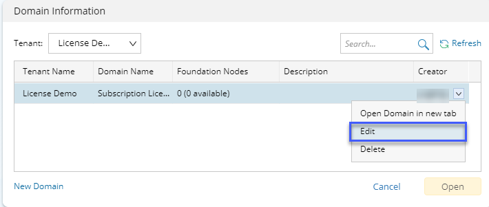

6.Select the existing tenant from the quick access toolbar, and select Edit from the drop-down list of the existing domain.
8.Click OK.
