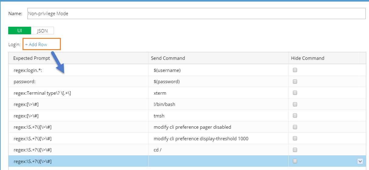

4.Configure the prompts and commands for a specific mode. Take Non-privilege Mode as an example.

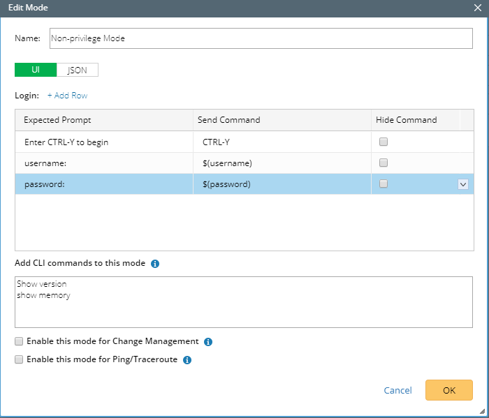

1)Point to the Non-privilege Mode entry, click the drop-down icon and select Edit.
2)In the Edit Mode dialog, add prompts and commands by either of the following ways:

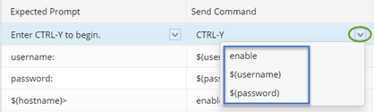

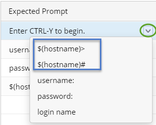

On the UI tab, click Add Row to add a new pair of prompt and command.. The definition contains three fields:
On the JSON tab, configure the prompts and commands by using JSON scripts. The JSON definition contains the following elements:
Sample JSON Script: { |
Note: The content defined on the UI tab and JSON tab is synchronized with each other. Therefore, you can select either way to define prompts and commands for only once.
3)In the Add CLI commands to this mode field, enter the commands that can be executed in this mode.
4)Click OK.
