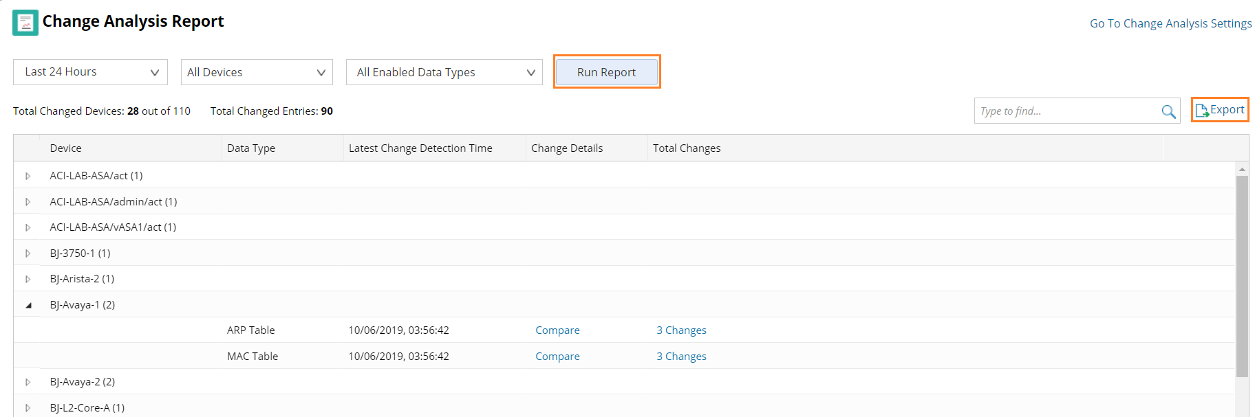

Global Change Analysis Report
Global change analysis report allows you to track the data change status of the entire network involving hundreds of network devices.
Complete the following steps to view global change analysis report:

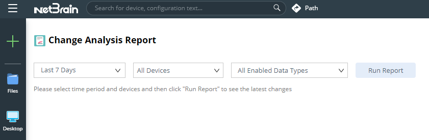

1.Click the start menu and then select Change Analysis Report.
2.Specify a time range, device scope, and data type for the change analysis report.
3.Click Run Report.
Note: See Parameters for more details about the change analysis report definition. You can also click Export to export change analysis report as .zip file.

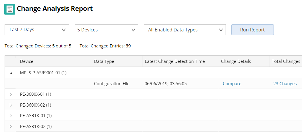

Map-Based Report
Different from global change analysis report, map-based change analysis report only focuses on the data change status of your target network devices defined on a map.
1.On a map, click Map > View Change Analysis Report from the map toolbar.
2.View the auto-generated report based on the map devices within the last 7 days.
Note: See Global Change Analysis Report for more details about the report configuration.
Tip: Map-Based Report can also be launched by right-clicking the blank area on a map and select View Change Analysis Report.
