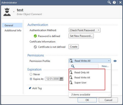

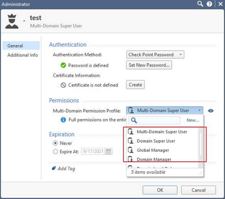

1.Assign permissions to the account that you use for your NetBrain system to access the Checkpoint data. You can select any of the following three permission profiles in General > Permissions > Permission Profile.

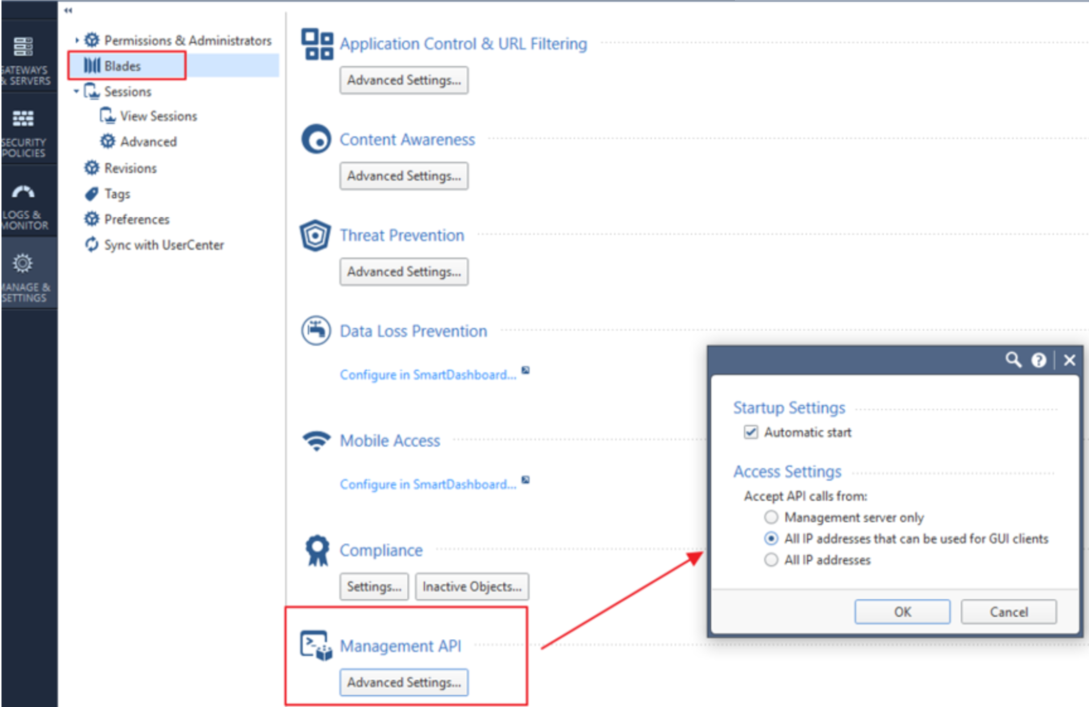

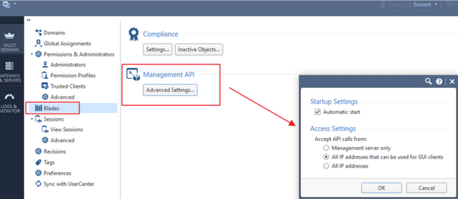

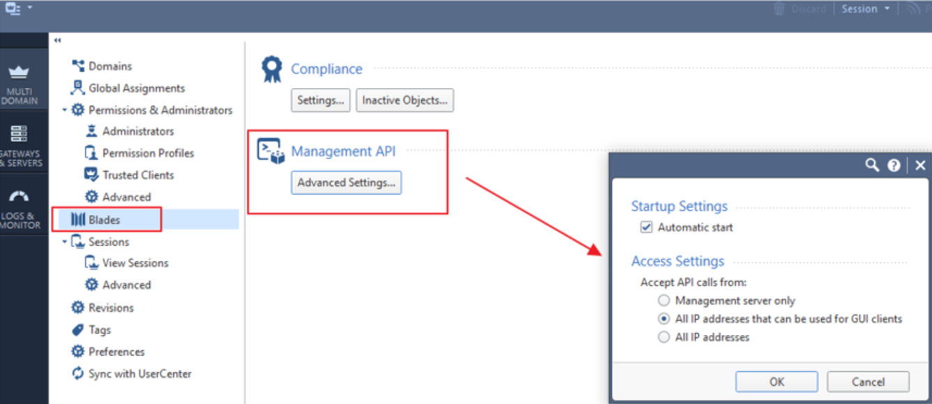

2.Enable API access to accept API calls from your NetBrain Front Server. Go to Blades > Management API > Advanced Settings > Access Settings, and select the All IP addresses or All IP addresses that can be used for GUI clients option.

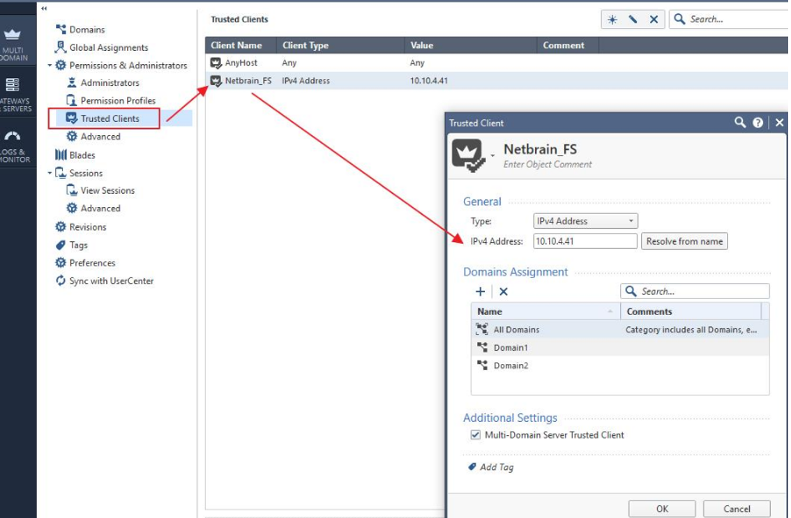

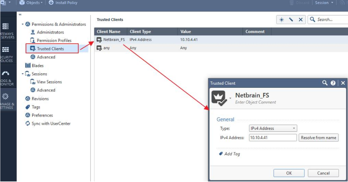

Note: If you select the All IP address that can be used for GUI clients option, add the IP address of NetBrain front server to the Trusted Clients as follows:

1.Assign permissions to the account that you use for your NetBrain system to access the Checkpoint data. One of the following permissions is required in General > Permissions > Permission Profile.
Note: If you cannot discover the devices or retrieve data with a specified permission, promote the permission to give it a try.

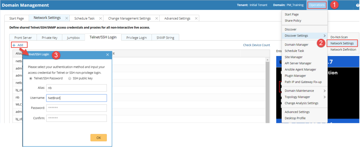

In the Domain Management page, configure the network settings required for Checkpoint Firewall R80 in the system, such as SSH/Telnet Login, Privilege Login, and SNMP String credentials, for Checkpoint Firewall R80. Refer to Online Help for more reference.

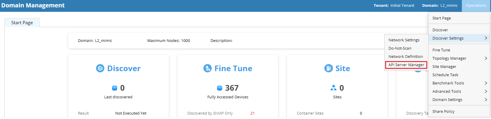

1.In the Domain Management page, select Operations > Discover Settings > API Server Manager from the quick access toolbar.

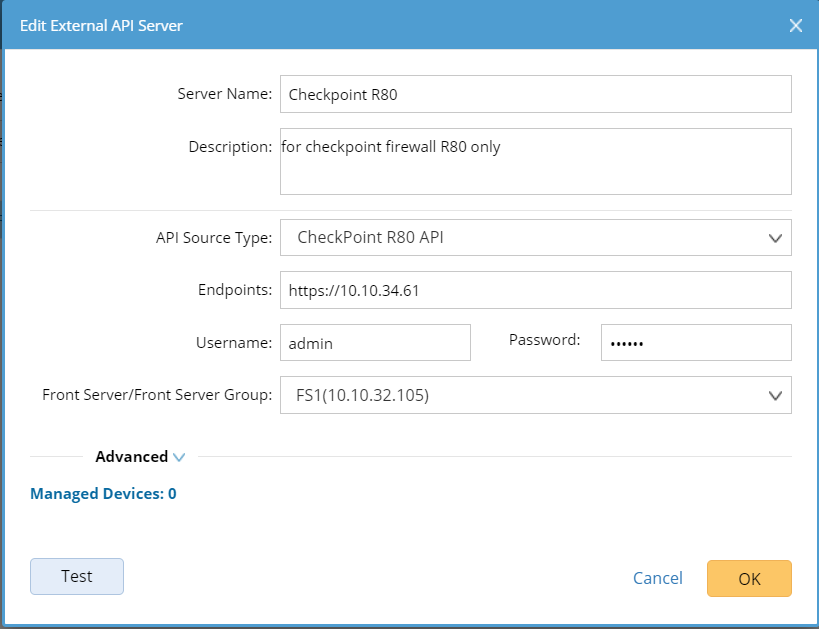

2.On the API Server Manager tab, click Add and configure the required fields.
1)Enter a unique name and a description of the API server.
2)Select CheckPoint R80 API from the API Source Type drop-down.

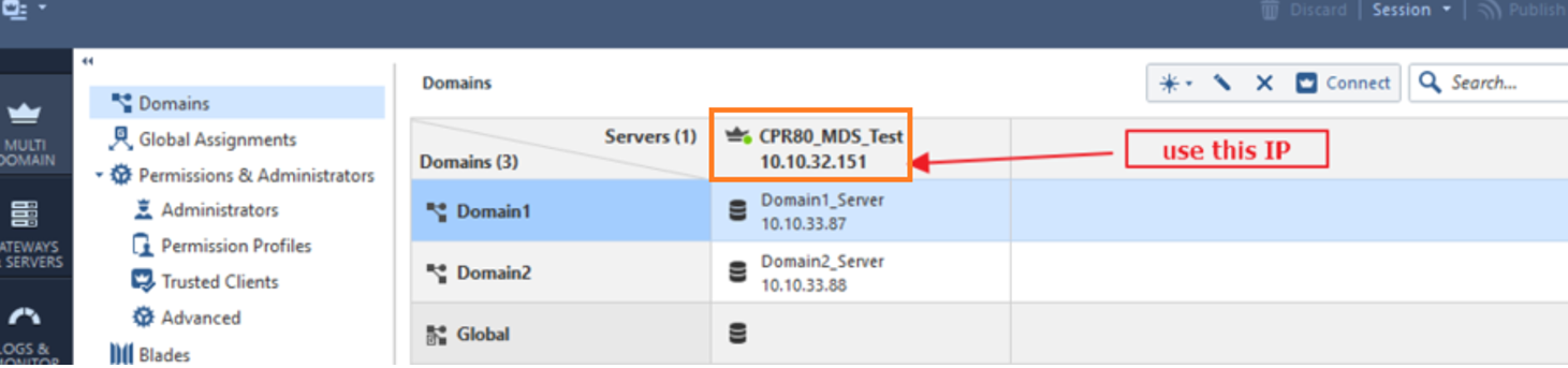

3)In the Endpoints field, enter the address of the Checkpoint Management Domain. The format is https://IP_Address.
Note: Use the multi-domain server IP address in the table header as follows.
4)In the Username and Password fields, enter the username and password of the account that you have configured in the Checkpoint Manager.
5)Select a Front Server that can connect to the Checkpoint Manager from the Front Server drop-down.

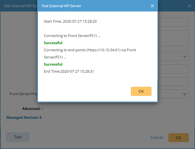

6)Click Test to check the connectivity between your NetBrain Front Server and Checkpoint Management Domain.
7)Click OK.

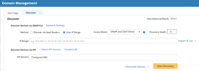

After finishing the configurations at both Checkpoint Manager side and NetBrain sides, you can get started to discover Checkpoint Firewall R80 to one of your NetBrain domains.
Note: To ensure that CheckPoint Firewall R80 can be correctly discovered in the system, perform the discovery via CLI/SNMP first and then re-run a discovery via API.

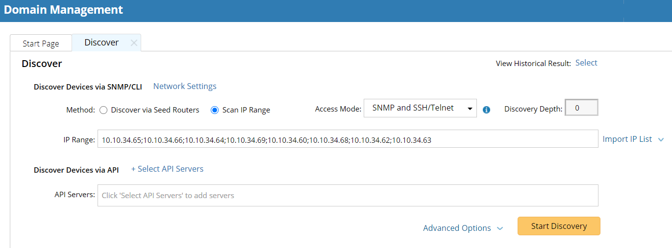

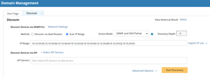

1.Discover Checkpoint Firewall R80 via CLI/SNMP.
2)On the Discover tab, select Scan IP Range in the Method field.
3)In the IP Range field, enter all the management IP addresses of your Checkpoint Firewall R80 devices and separate two IP addresses with a semicolon.
4)Keep other options as default and click Start Discovery.
2.Re-discover Checkpoint Firewall R80 via API after the SNMP/CLI discovery is completed.
1)Clear the IP addresses from the IP Range field.
2)Click Select API Servers and select the one you have configured.
3)Keep other options as default and click Start Discovery.
Note: The discovery only retrieves basic information about Checkpoint Firewall R80 via Checkpoint APIs. After the discovery, you need to run a benchmark to retrieve more data.
After the discovery is done, run a benchmark task to update the data of Checkpoint Firewall R80 devices and build topology in the system. Refer to Online Help for more reference.
