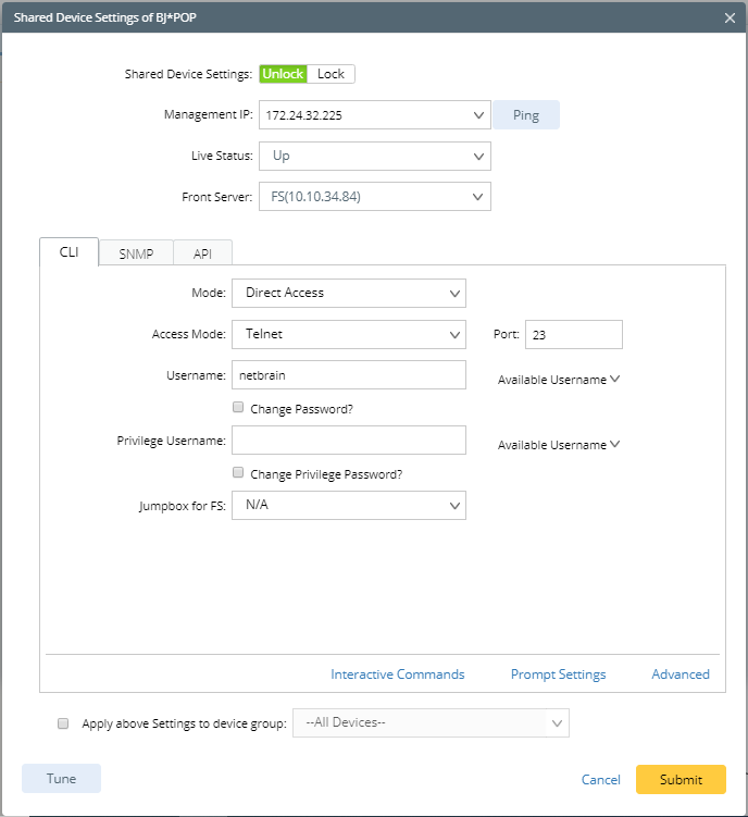

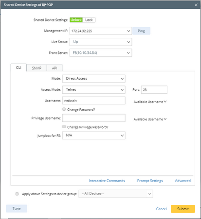

1.Right-click the device "BJ*POP" on a map page and select Shared Device Settings from the drop-down menu. The following dialog is opened.
2.To change Management IP or Front Server, select an item from the corresponding list and then click Ping. The system will use the Front Server to ping the corresponding interface and automatically update the Live Status field with the ping result.
Management IPBy default, the first ping-able interface IP address during the first-time discovery is set as the management IP address.
Front Server/Front Server Group The Front Server or Front Server Group that is responsible for accessing the device or the external API server to retrieve data.
Tip: The selected Front Server is synchronized with the device allocation changes in Shared Network Settings or API Server Manager.
3.Configure the settings for each access method based on your needs.

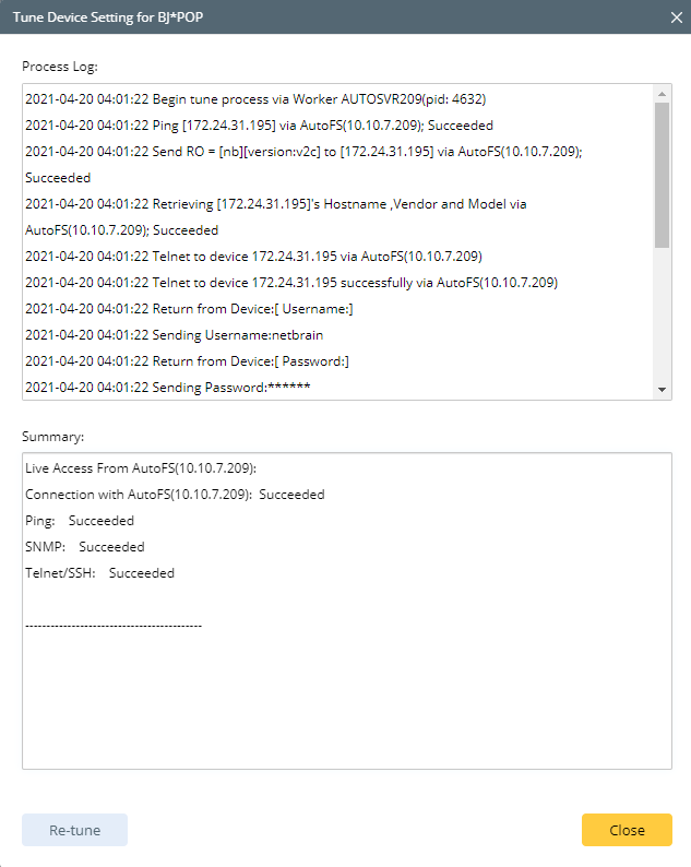

4.Click Tune to check the reachability of live devices by using the above settings. If not reachable, the system will overwrite the settings by polling the credentials configured in the Shared Network Settings. You can view the process log and tuning results as follows.
Tip: You can apply the changes of settings to a device group if required.

CLI
Used to specify the mode and required parameters to access the device via Telnet or SSH. This method contains the following two modes and corresponding parameters:
Direct Access Modeaccess the device directly to retrieve data.
oAccess Mode/Port — the mode and the corresponding port to access a device, including Telnet, SSH, and SSH Public Key.
oUsername/Password — the username and password for Telnet/SSH login. By default, the password is not displayed in UI.

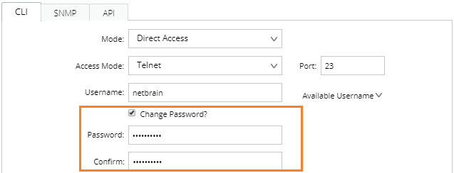

oChange Password? — If you want to change the password, select this check box. The area for entering the password is displayed.
oPrivilege Username/Password — the username and password to enter the privilege mode. By default, the password is not displayed in UI.
oChange Privilege Password? — If you want to change the privilege password, select this check box. The area for entering the password is displayed.
oJumpbox for FS — select a jumpbox if the device cannot be accessed directly via the Front Server (FS). The Jumpbox must be predefined in the Network Settings.
oInteractive Commands — customize the interactive CLI prompts and responsive commands for this device. Besides the exiting two pairs, you can add more pairs. For detailed rules and formats, refer to Prompt and Command Definition in GUI.
Note: To define the generic interactive commands for devices that use the same driver, refer to Device Driver.
oPrompt Settings — customize the advanced CLI prompts and commands. See Configuring CLI Prompts for more details.
Via Other Devices — access the device through another device to retrieve data, for example, the parent device of a virtual device.

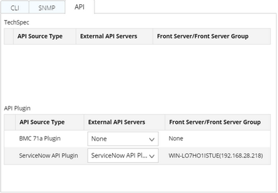

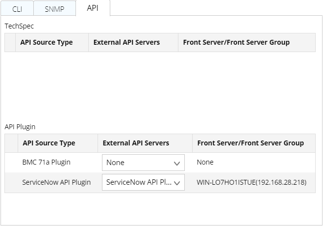

API
Used to specify the API server to retrieve device data from an external API server.
Note: The external API servers must be predefined in the API Server Manager. If a Front Server is specified when defining the API server, the system will use the specified Front Server to access the external API server. See Adding an API Server for more details.
Note: The Cisco ACI or VMware ESXi source types in the TechSpec area are only available for the devices in Cisco ACI or VMware ESXi networks, and their external API servers cannot be manually specified.
