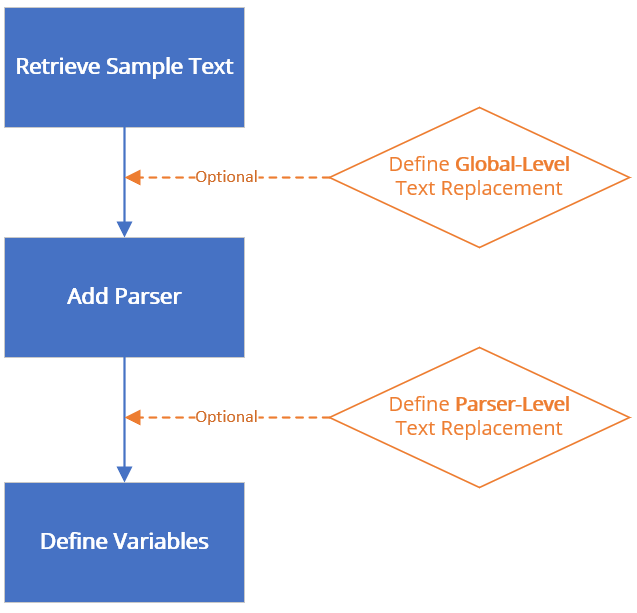

Text replacement can be defined in two levels:
  • Global level: search and replace a string in the whole range of sample text.
  • Parser level: search and replace a string in the given range of text that has been matched by a specific Parser’s definition.

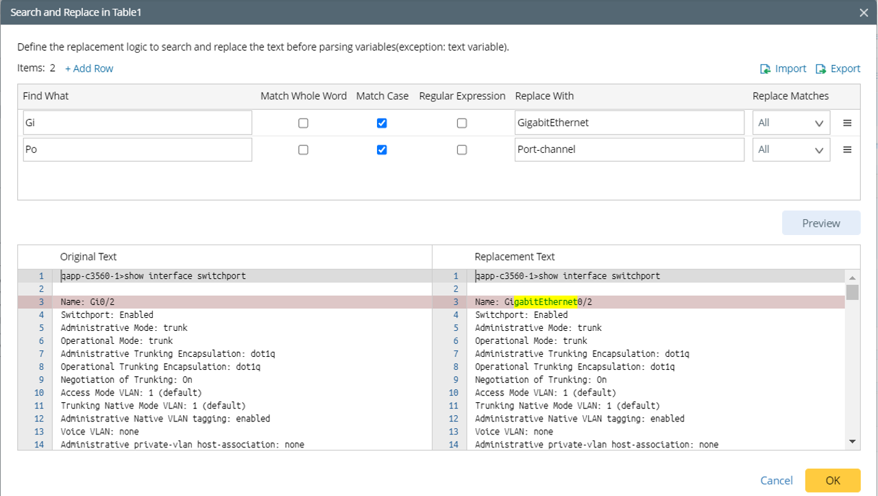

When defining a text replacement, you can add multiple replacement rules. Each rule contains two objects as follows.
  • Find What - the text you are searching for in the given range.
    • Match Whole Word - once enabled, searches will only match if the result is a whole word, e.g., a search for “FastEthernet” will not return “FastEthernet1/2”.
    • Match Case - once enabled, search terms are case-sensitive, e.g., a search for “ethernet” will not return “Ethernet”.
    • Regular Expression - once enabled, search terms will use the regular expression engine to find complex patterns in the text; otherwise, search terms will be interpreted literally.
  • Replace With - the text that will replace what is matched.
    • Replace All Matches - replace all matches in the text scope.
    • Replace First Only - replace the first match only.
