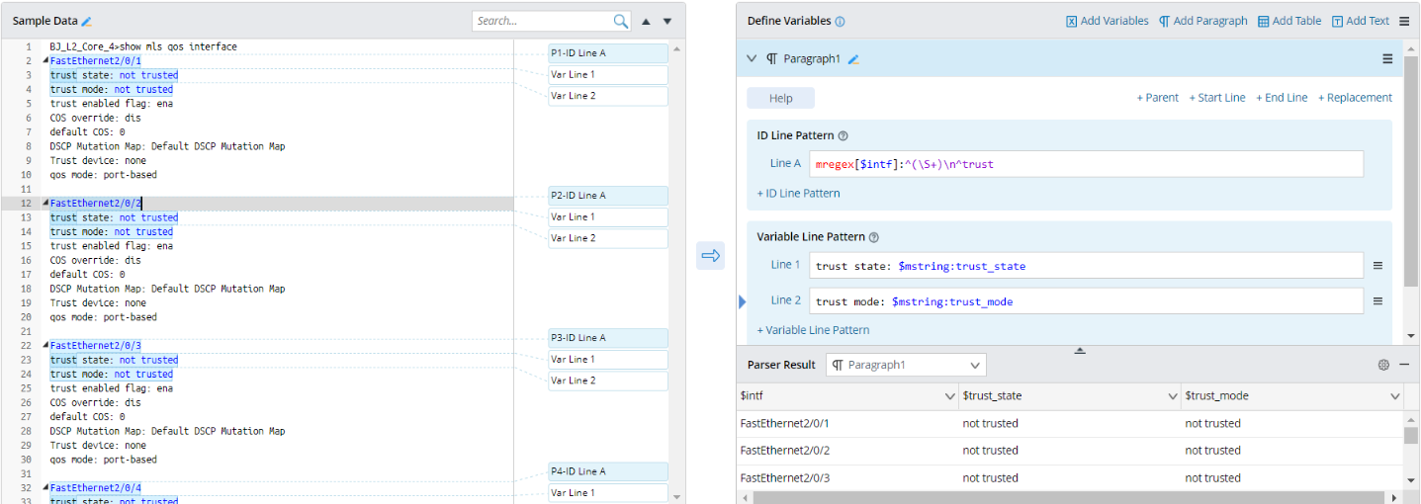

The Identifier (ID) Line is the key to identifying recurring paragraphs. For those duplicate variables that reside in recurring paragraphs, you can use ID Line Pattern to divide lines of text into segmented paragraphs first and then use Variable Line Pattern to define more variables.
Information Note: ID Line Pattern only applies to Paragraph Parser, and multiple ID Line Patterns are allowed.
The default and mandatory ID Line is labeled as ID Line Pattern A, which divides lines of text into paragraphs. As shown below, the line of text that matches ID Line A’s line pattern is highlighted in each paragraph and labeled with numberings. The parsed values of variables are differentiated by the foreground color. When you click on a variable’s value in the parsed result, the value text will be highlighted in the sample text.

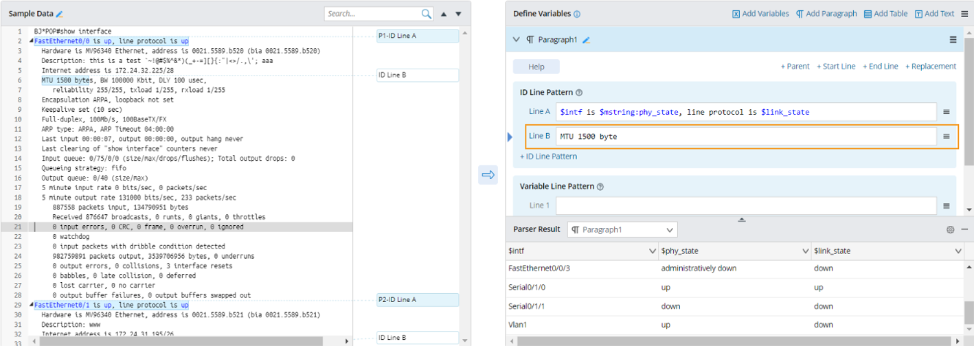

Beyond the ID Line Pattern A, you have options to add more ID Line Patterns B~Z as filters to filter out unqualified paragraphs.
For example, the ID Line Pattern A of the following Paragraph Parser uses the interface name as the identifier to separate paragraphs, and the ID Line Pattern B further defines the condition that only the paragraphs for those interfaces, of which the MTU’s value is 1500 bytes, will be used for parsing. The lines of text that match the line pattern of ID Line B~Z are also highlighted and marked with a label. The labels for ID Line B~Z do not contain numbering because their numbering keeps the same as the paragraph numbering of ID Line A.
