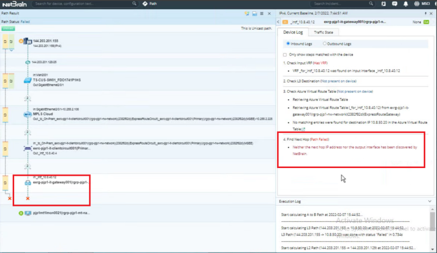

If the path failed, check the node/device which causes the failure and find the cause message in the path logs details. If you see Path Failed message in Find Next Hop procedure, follow the instructions below.
Troubleshoot
  1. Check the path log details and see if the specific route has been matched. For example, if it matches the route in VRT (virtual route table), check if the out interface and next hop device in VRT data look good or not.

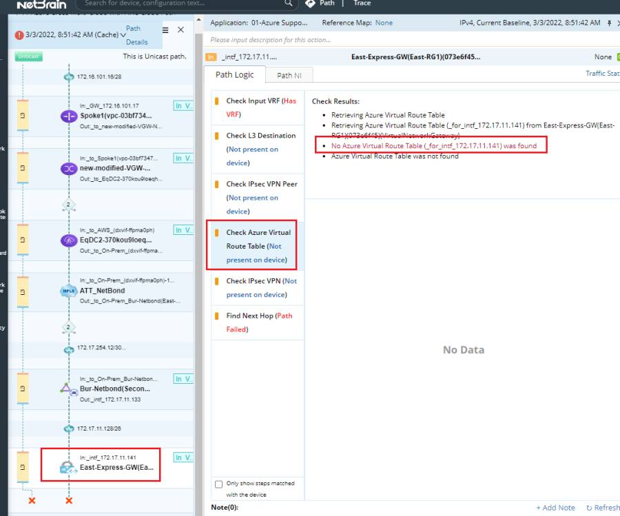

  2. Check whether an error message contains "No Azure Virtual Route Table was found".
  3. Open the VRT from node and check the table content.
    If it is empty, open the plugin manager to debug and run the Azure VRT plugin to trigger the VRT generation again.

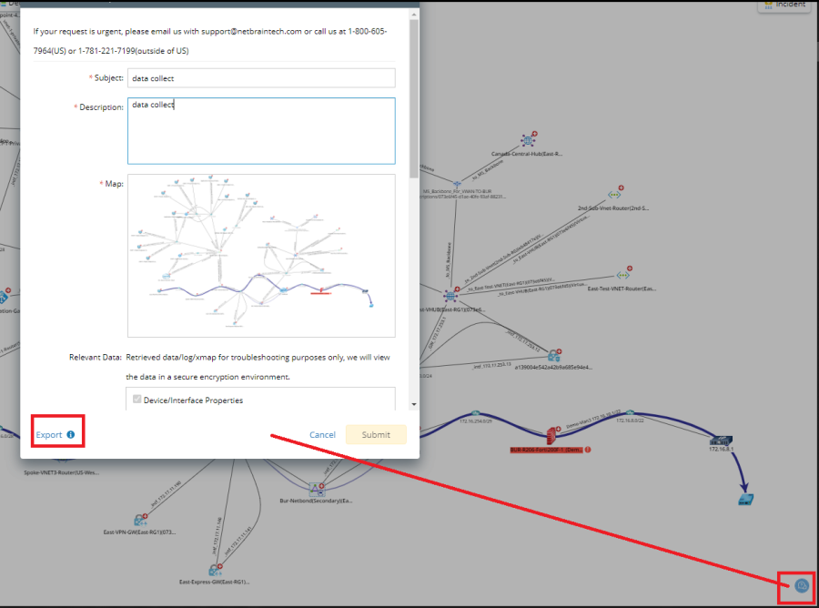

  1. Collect Data
  • Map Data:

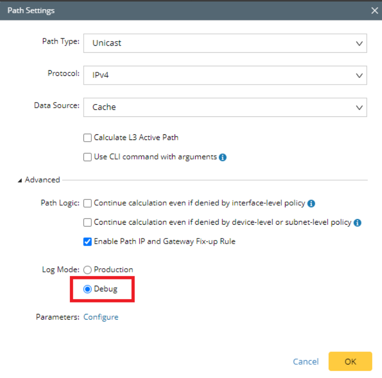

    • Enable the path debug mode.
    • Export Map by clicking Contact NetBrain to export the node data. Remember to draw all the nodes/devices involved in the path on the map and expand all their neighbors before exporting the map.
