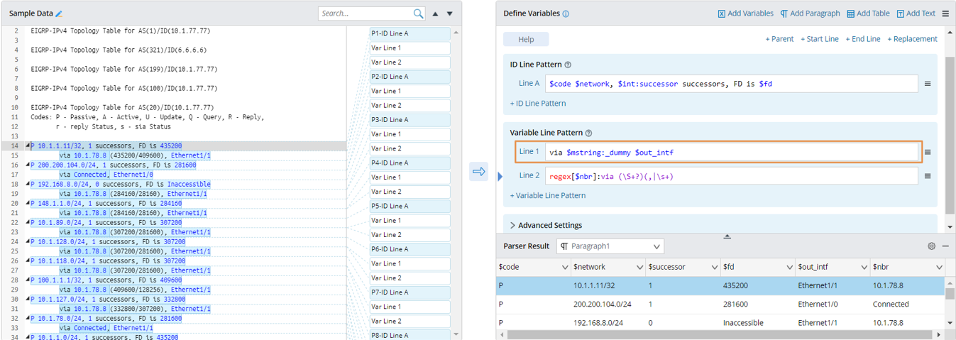

Use a dummy variable to skip a specific type of variable you are not interested in, like a placeholder. For example:
  • $mstring:_dummy indicates skipping multiple lines of string.
  • $string:_dummy($_dummy) indicates to skip a string.
  • $int:_dummy indicates to skip an integer.
  • $float:_dummy indicates to skip a float.
Take the EIGRP neighbor as an example: if you want to parse its output interface, the previous string starting with “via” must be skipped.
