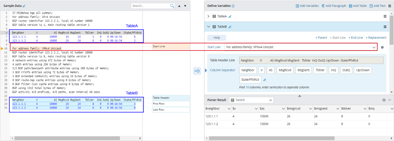

Highlight the target line of text in the Sample area, and click the arrow () to duplicate it in the Start Line field.
For example, without a start line, the Table Parser always parses Table A using the default top-down sequence. To parse Table B instead, you need to add a start line. The line of text that matches the defined start line is highlighted and marked as Start Line.

For example, the following raw text contains two tables of the same format, Table A and B. You can define a Table Parser AS_1 to parse Table A and a Table Parser AS_2 to parse Table B. Without a start line, the Table Parser AS_2 always parses Table A by using the default top-down sequence. Selecting $AS_1.lastRow in the Start Line field indicates the last row of Table A will be used as the start line of Table Parser AS_2.
