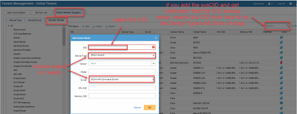

  3. Use either way to add new entries to the table list.
Adding entries manually
  1. Click Add. The Add Vendor Model dialog box prompts.
  2. Enter the required information, such as OID, device type, vendor, and model.
  3. Click OK.
    Information Tip: If you want to customize the device icon, right-click the target entry and select Change Device Icon.

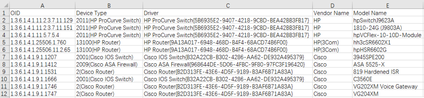

Importing a .csv file
  1. Create a .csv file in your local folder. For example:
  2. Click Import at the upper-left corner of the table.
  1. Select the .csv file you create and click Open.

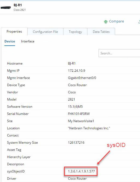

Resolve Unclassified Device or Driver Mismatching
  1. Check the sysOID for the device in the Device Detail pane.

  4. Add the sysOID from step1 to the OID field in Add Vendor Model window and select the proper Device Type and Device Driver. Click OK. Graphical user interface, application
    Information Tip: If the sysOID already exists, search it from the search bar, then modify it.
