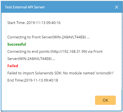

Error Scenario: SolarWinds Orion SDK library isn’t available
Possible Resolution: Make sure NetBrain is upgraded to IE 11.1 or later, or contact NetBrain Support for a solution.

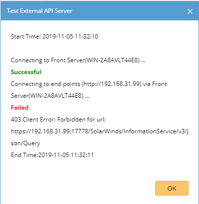

Error Scenario: The entered credentials are incorrect.
Possible Resolution: Confirm credentials specified in the Solarwinds API Adaptor configuration and retry.
