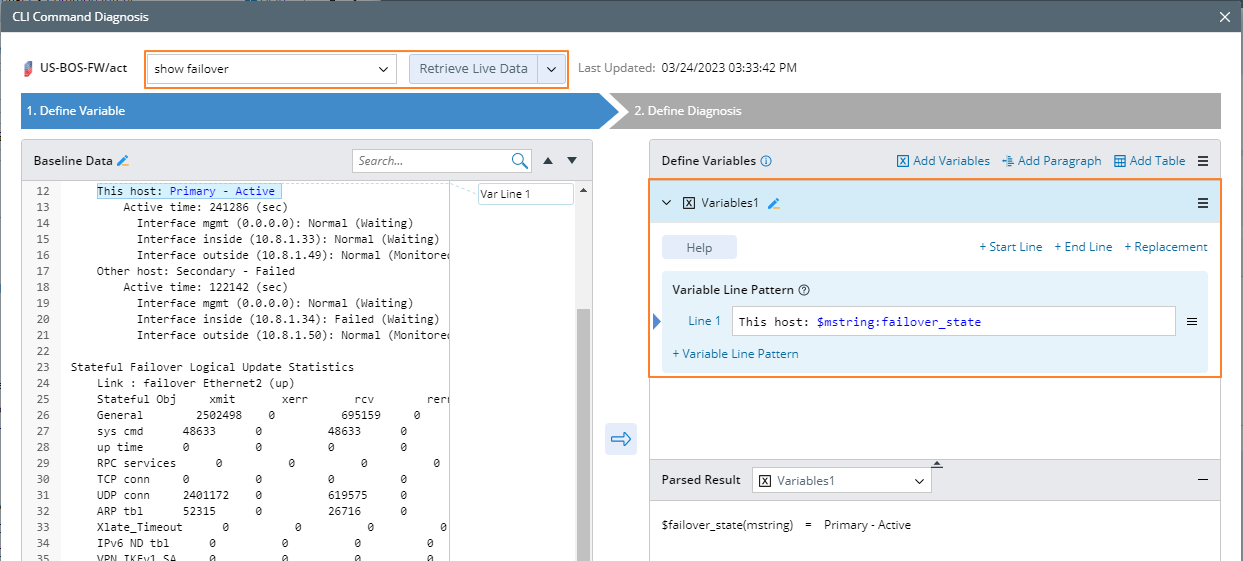

Complete the following steps to schedule an intent to verify the impact of network change, for example, monitor ASA failover status.
  1. Build an intent to parser the key metric of date obtained by command show failover.
  2. Compare the current key metric with last.

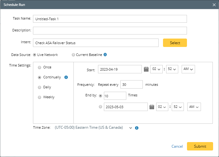

  3. Schedule the intent to run it periodically. See Settings for Creating a Scheduled Intent Task for more information.
    Information Note: After this intent is scheduled, a scheduled task icon will be displayed behind the intent name in the View mode. Hovering this icon can view the scheduled information.
When you define a scheduled task:
  • One scheduled intent task can only have one intent.
  • Able to set the data source, execution time, and frequency (Once, Continually, Daily, and Weekly).
  • For the Continually settings, you must set the end by times or end by date (cannot be longer than 2 weeks from the start time). If the Times checkbox is selected, the Times*Frequency must be less than 2 weeks.
    Information Note: You can create multiple scheduled tasks for one intent.

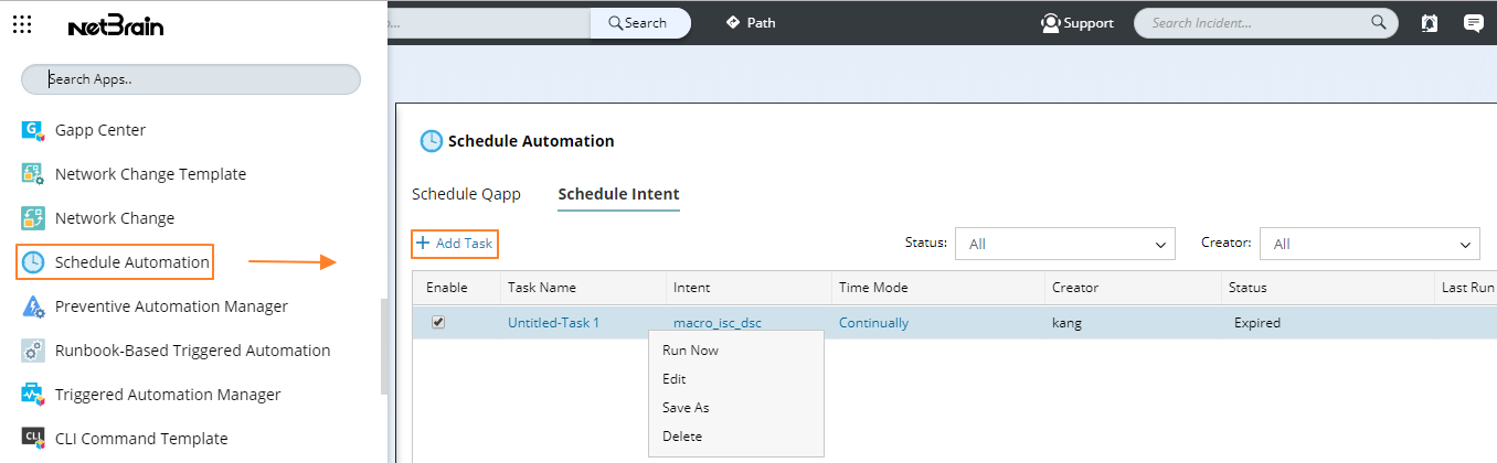

Manage Scheduled Intents
You can manage the scheduled intents in Schedule Automation > Schedule Intent.
Information Note: You can also manage the scheduled intent by navigating to the Doman Managemnt page > Schedule Task > Schedule Intent.
