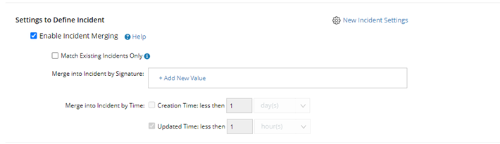

Configure the following settings to merge Incidents:
  • The option to Enable Incident Merging.
  • The option Match Existing Incident Only:
    • Enabled: API calls belonging to this Incident type will be discarded if no existing incident matches this API call.
    • Disabled: A new incident will be created if no incident matches the API call.

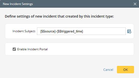

  • New Incident Settings:
You can customize this subject by typing any text and inserting any data field from the category and built-in special fields ({Incident Type}, {source}, {category}, and {triggered time}).
The default incident subject is {source} - {triggered time}.
 Example: You can create a subject: Interface {interface name} of device {device} is down: from {source} on {triggered time}.
Enable Incident Portal: An incident portal will be generated.

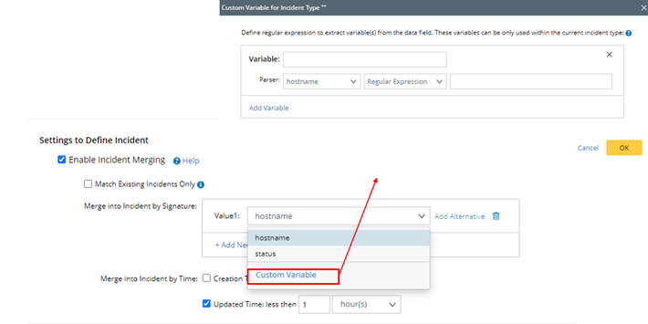

  • Merge into Incident by Signature:
You can select one or multiple data fields (or custom variables ) as the signature to merge the tickets to an incident.
  1. Click Add New Value.
  2.  Select a variable from the drop-down list.
  3. (When one value has multiple variables) Click Add Alternative to add an alternative.
    Example: value 1 = Configuration_itemName or $device.
    The use case for the multiple variables is that a ticket may use either Configuration_itemName or $device as the device name reporting this Incident.
    Information Tip: The system will use the first variable with no empty value for the comparison.
  1. When you want to delete a value, click .
  2. You can define multiple values for the signature.
 Example: For Interface Error incident type, you may define $device_name as value 1 and $interface_name as value2. The tickets will be merged if both $device_name and $interface_name are the same.
    • Custom Variable
      The value used for the signature may be a part of a data field such as $description and $detail_message.
      You can create a custom variable to retrieve the value from the data field by regular expression.
      The custom variable starts with $.
  • Merge Incident by Time:
    You can define how long TAF should look back to find the incident candidate to be merged.
    • Incident Creation Time
    • Updated Time
      Information Tip: When both times are selected, the system will use AND logic. If neither is selected, the system will search for all incidents.
