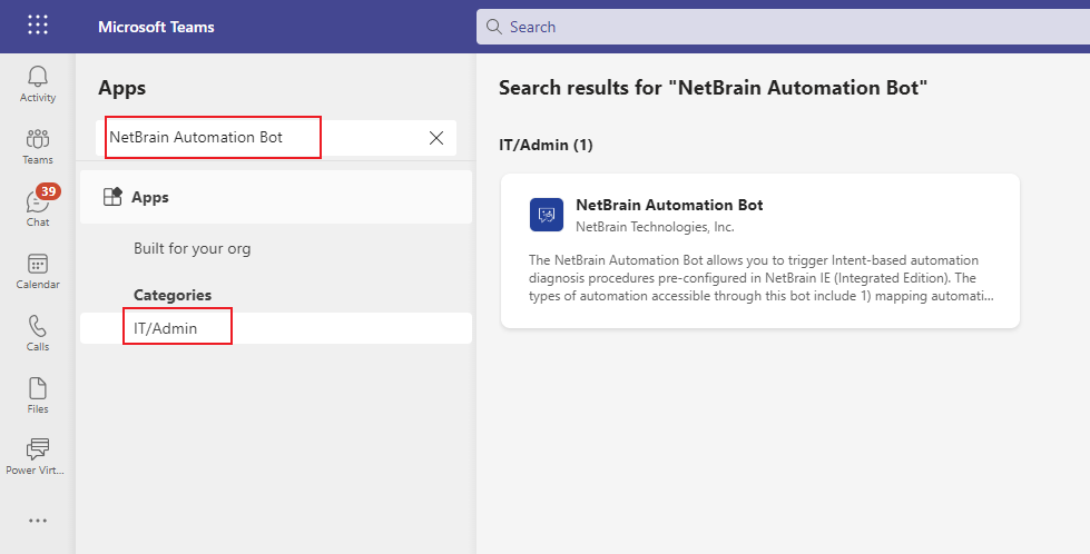

  2. Go to the Apps Store by clicking Apps on the lower left corner.
  3. In the Apps Store, search for NetBrain Automation Bot.

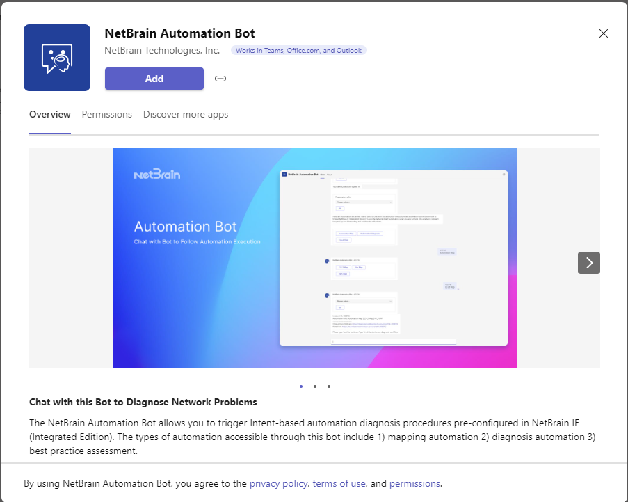

  4. Click Add.
  5. The NetBrain Automation Bot is listed under Chat and you can start to chat with the bot.

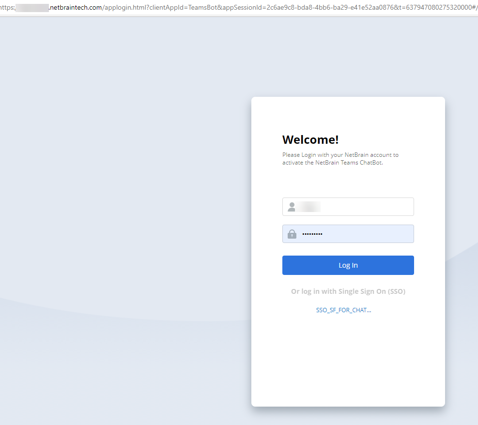

  1. Click Log in Button, and it will take you to the login page in a web browser.
  2. Input your NetBrain IE account credentials and click Log in.

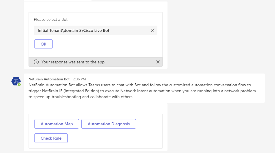

  3. After logging in successfully, you can select a Bot that was pre-customized in NetBrain IE to trigger automation diagnosis.
  4. Follow the link to open the NetBrain map or incident portal.
