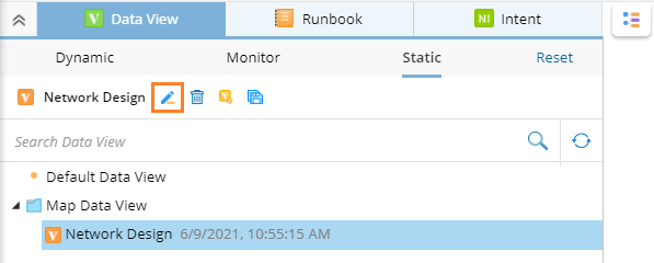

  1. On the Static tab of the Data View pane, double-click Network Design to apply it to a map.
  2. Click the icon to edit this static data view.

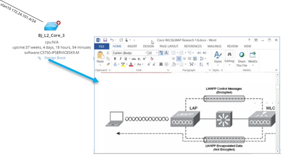

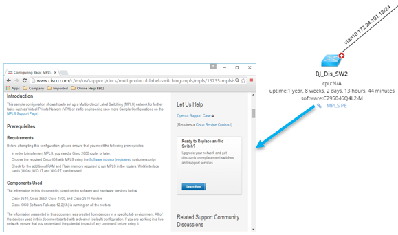

Enter Label / LinkAdd a hyperlink as a data unit.

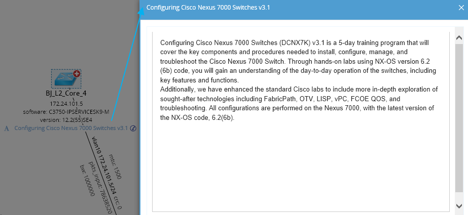

Insert TextAdd a format note as a data unit.
Attach FileAdd an attachment as a data unit.
