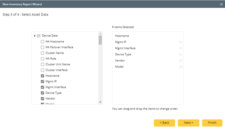

- Select the asset data that you want to include in the inventory report. Click Next.
Note: This step differs as per the report type selected in step 2). If you select Qapp Report as the report type in step 2), you will have a different dialog for step 3). See Customize a New Qapp Report for details. - Preview the first five entries of the report. Click Finish.
