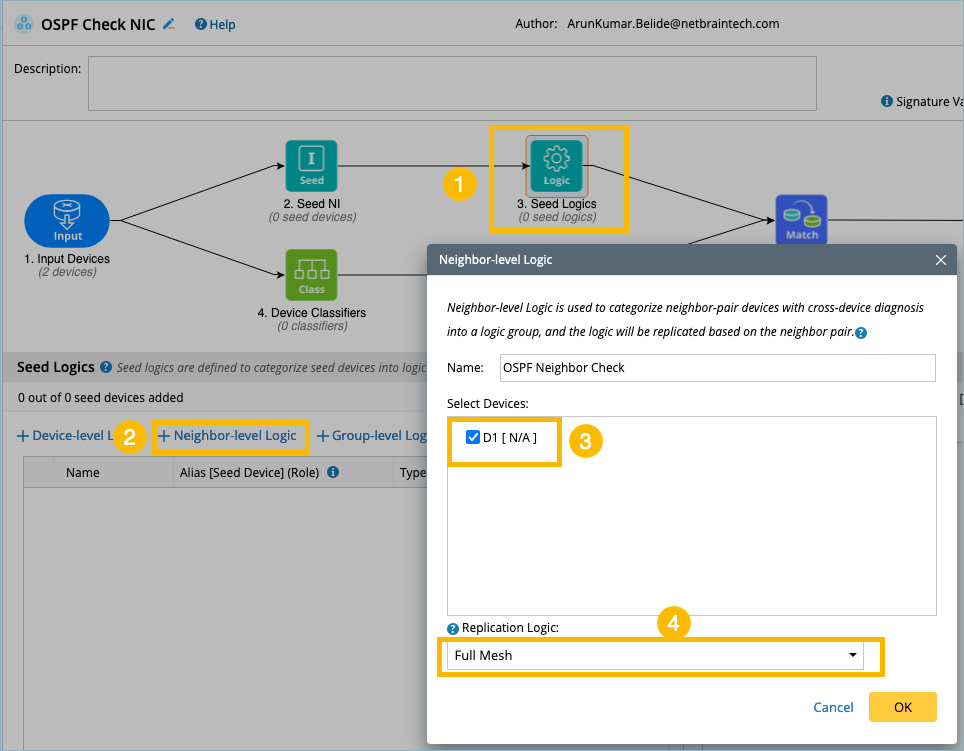

Step 3: Define the Seed Logics for NIC. You will define the seed logic for the Home NI and Child NIs. By default, the Home NI is set as the current NI. You can expand the Intent Family tree and select the Home NI or Child NIs to set it as the current NI. Only the Seed Devices under the current NI can be selected when defining the Seed Logics for the current NI.
In this example, we add the Neighbor-level Logic for both Home and Child NI and select the Full Mesh as the replica logic.

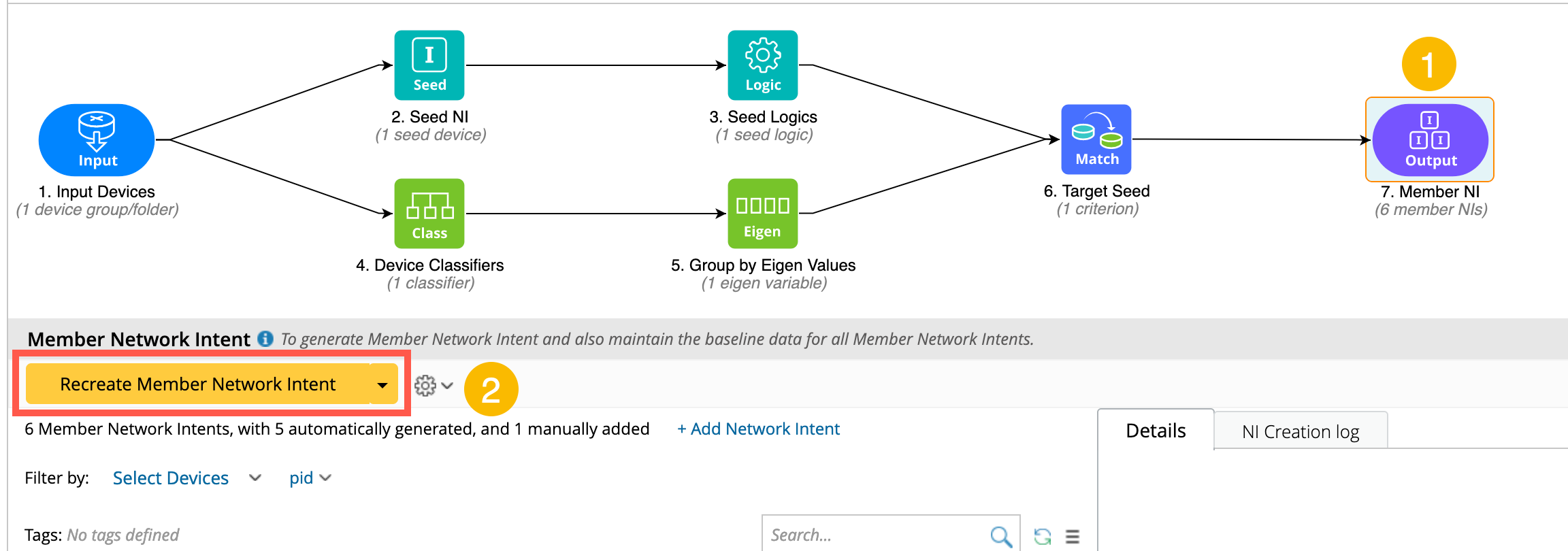

Step 7: Generate Member NI. Click on Create Member Network Intent to generate Member NI. Both Home NI and Child NIs will be replicated.
The logic to generate Member NI has been adjusted for Child NI: The Eigen Value and Signature Value are only generated for Home NI, not for Child NI; The name of the generated Child NI and its Intent Map will be the same as that of the original Child NI.

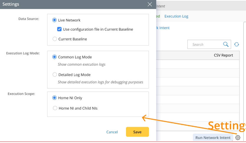

Execute Member NI with Child NI
There are two execution scopes for Member NI: Home NI only or Home NI and Child NIs. The execution scope can be set by clicking on the gear icon on the Member NI node.
