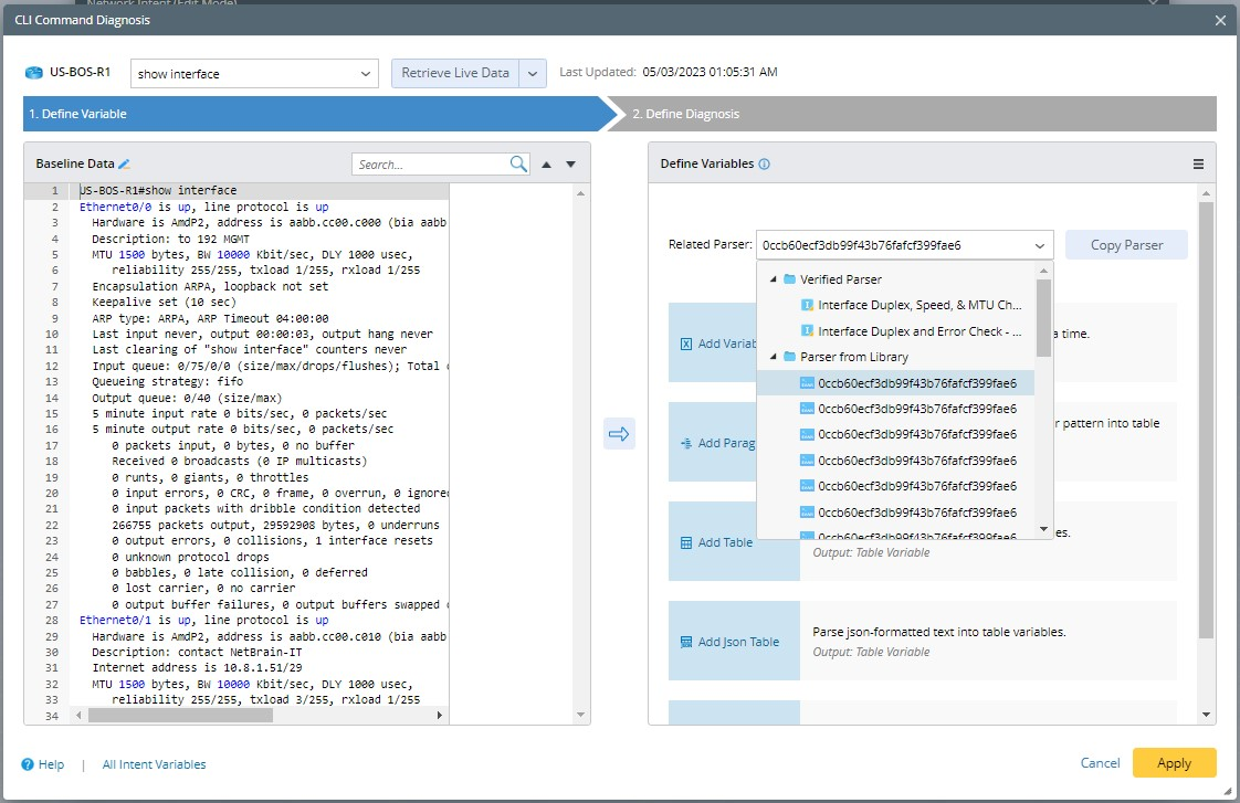

Instead of creating a new Parser, you can select an existing Parser and copy it to NI (the system makes a hard copy of the existing Parser, so you can modify the Parser without affecting the original one). You can copy two types of Parsers:
  • Verified parsers, which have been tested by NIT decode engine. The Verified Parser will work in your network unless you upgrade the device's OS or the output format of the command changes.
  • Parser from Library, which are filtered by the device type and the command.

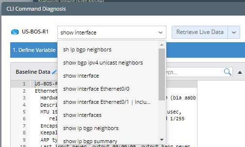

Before copying parsers, you are recommended to select a CLI command from the list of Verified CLI Commands, which ensures at least one corresponding verified parser is available in the Related Parser area.

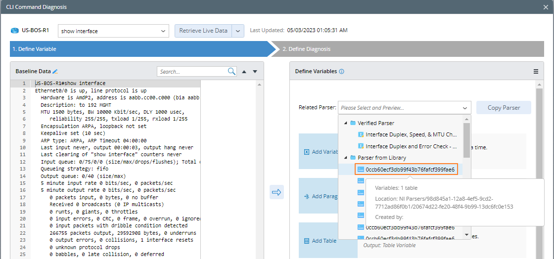

Parser from Library
The matched parsers are the visual parsers filtered from the Parser Library by the device type and command of the current device.
Hover over the list of matched parsers to view the Parser info in the tip window, which contains the variable type and total number of variables, and the author of the Parser.

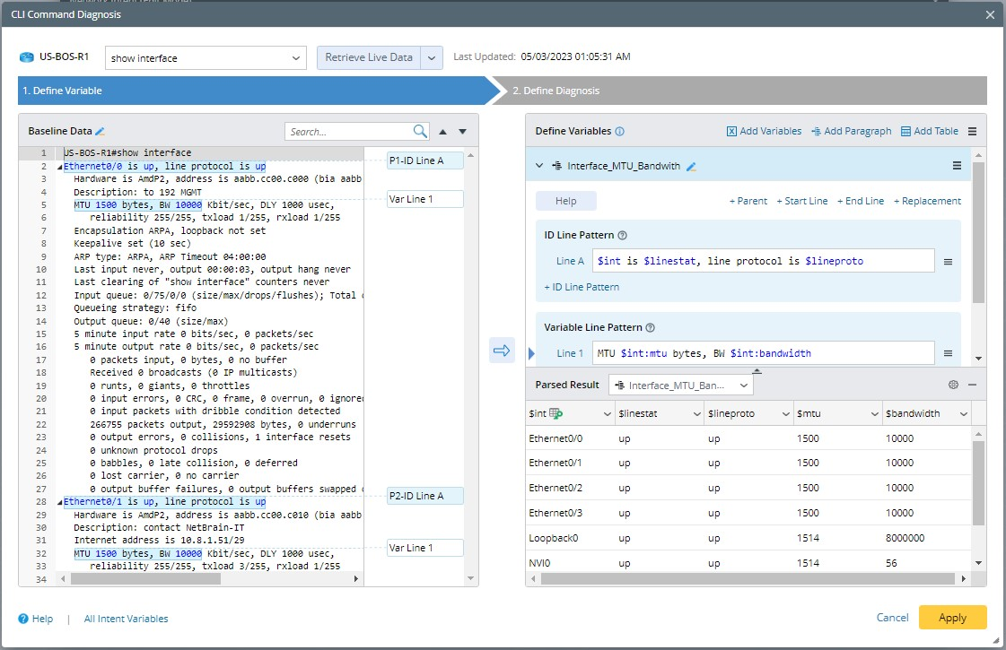

1. Preview Parser
Click the matched Parser in the list, then the values corresponding to all variables in the Parser will be highlighted in the Baseline Data by the selected Parser.
If the Baseline Data is null, click the selected Parser, and the sample data in the parser definition will be displayed in the Baseline Data pane on the left to highlight the parser variable. At this time, the sample data will not be used as the NI's baseline data. After the baseline data is retrieved again, the preview effect of the Parser will be displayed in the Baseline Data pane.
2. Copy Parser
Click a matched parser from the drop-down list and the Copy Parser button. All the corresponding variable definitions in the Parser will be copied to the current command to generate variables.
