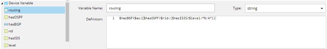

Beyond existing built-in variables and parser variables, the system supports compound variables in a data view template definition to organize multiple variables to represent complex network semantics. For example, you can define a compound variable,
$routing = $hasBGP?$as:($hasOSPF?$rid:($hasISIS?$level:”N/A”)) , to present the following sematics:
  1. If $hasBGP is true, return the value of $as; if not, return the value of ($hasOSPF?$rid:($hasISIS?$level:”N/A”)).
  2. If $hasOSPF is true, return the value of $rid; if not, return the value of $hasISIS?$level:”N/A”).
  3. If $hasISIS is true, return the value of $level; if not, return ”N/A”.
Refer to Compound Variable Properties on how to define a compound variable,
