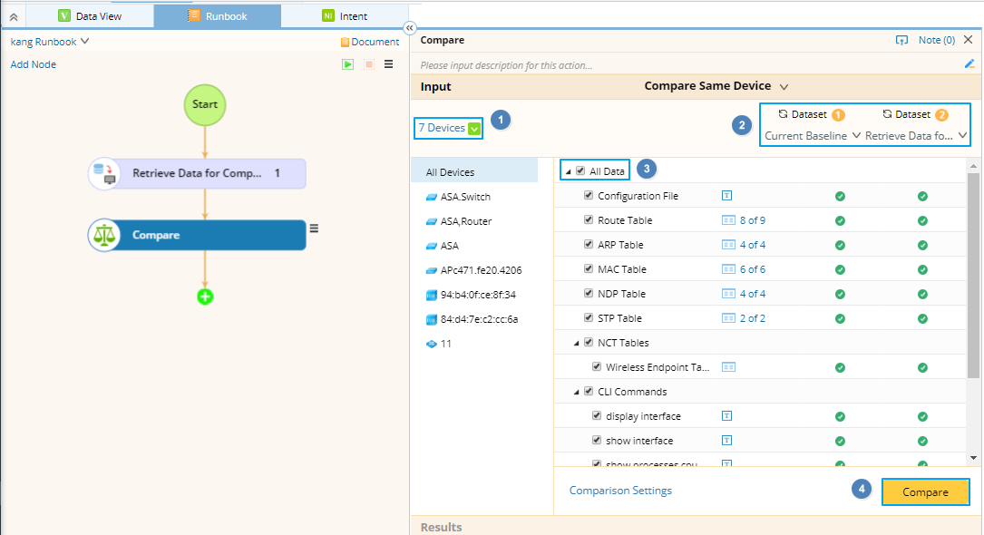

  1. On a map page, select Actions > Compare from the map toolbar.
  2. In the Compare pane, all devices on the map are selected as target devices by default. To customize the devices, click the icon.
    Information Note: The number of devices for comparison is recommended to be less than 100 for good performance.
  3. In the Dataset fields, specify two data sources to pull data for comparison. The system uses Dataset 1 as the main schema to compare with Dataset 2.
    Information Tip: The  icon means there is no data in the selected dataset.
  1. Select the data types you want to compare, including configuration file, data table, NCT and CLI commands.
    Information TIp: You can select sub-items under each data type for comparison. For example, select parser variables of configuration files or CLI commands, columns of data tables, or subtables of data tables and NCTs.
    Information Tip: To configure the maximum size for each data type that can be compared, click Comparison Settings. If the size of a file exceeds the threshold, it will not be compared.
  2. Click Compare.
  3. After the comparison is finished, select a device and a changed data type to view the detailed changes. See Comparison Results for more reference.
    Information Tip: The displayed comparison results can be exported to HTML files. To export the comparison result of a single data type, click the  icon and select Export. To export the whole result, click the  icon of the result entry under the Compare node and select Export Result.
    Information Tip: You can also click the hyperlink in the Results area to view the result summary.
