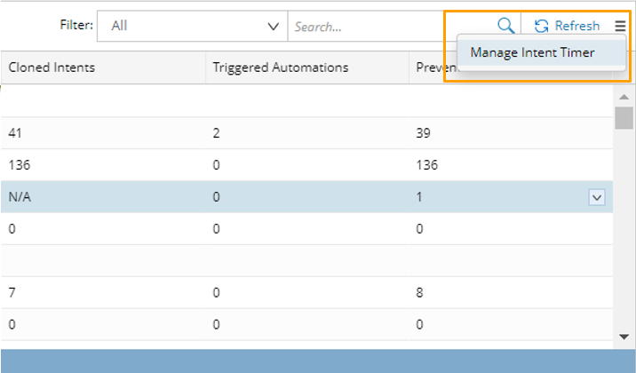

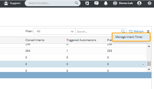

You can click the icon at the upper right of the Installed Intents pane, then select Manage Intent Timer to add a new timer and manage timers.

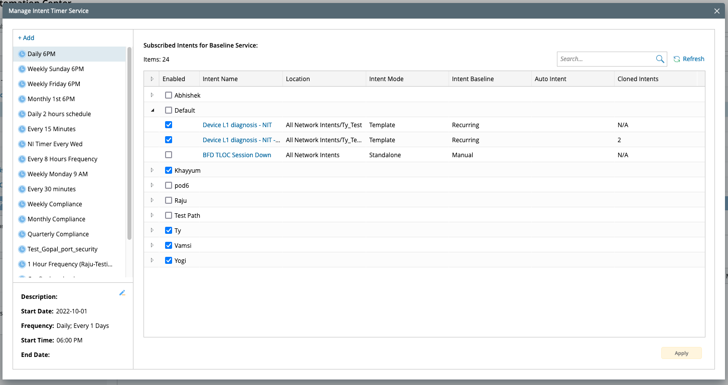

In the Manage Intent Timer Service window, you can view intent timers, add new intent timers and view how intent timers are applied to the intents in the intent library.
  • All the existing intent timers are organized in the left pane. You can click an intent timer item in the list to view its details.
  • The lower area of the left pane presents the basic information of the selected intent timer item.
  • The Subscribed Intents for Baseline Service  area to the right displays how many NITs use the current timer for baseline service.

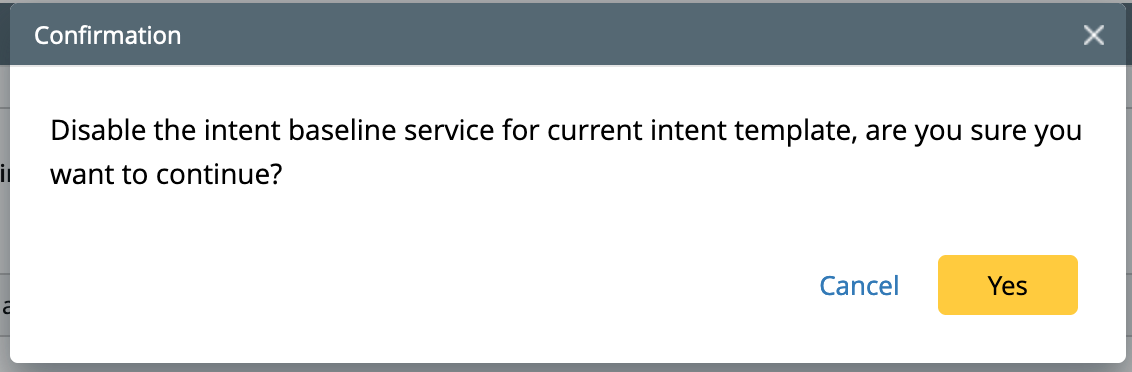

  • Disable baseline decoding for an intent: Uncheck an intent item in the Subscribed Intents for Baseline Service area.
A message will pop up to ask you to confirm the action.
