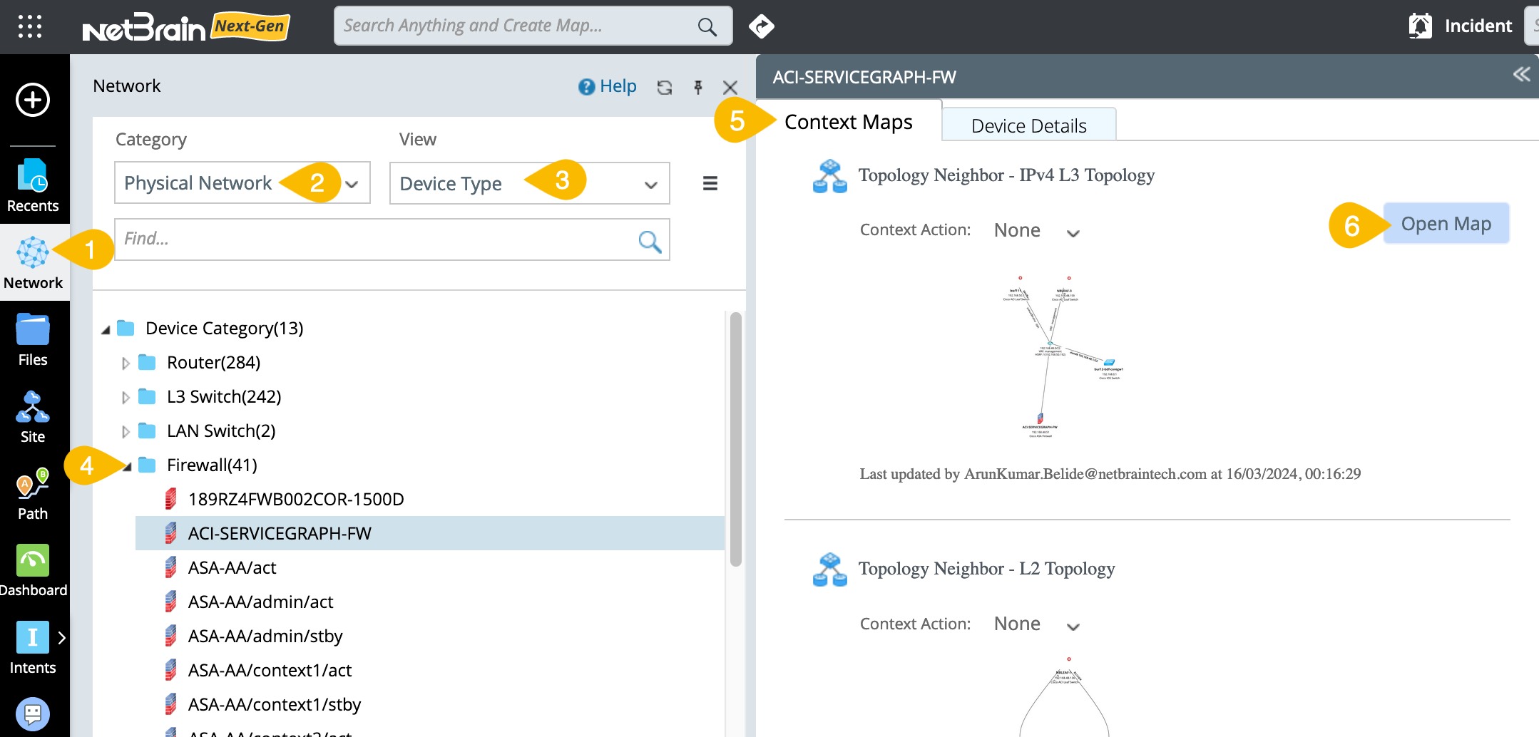

View Physical Network by Device Type
Devices are categorized by the main device type. To view the details and the context maps of a node, proceed with the following steps:
  2. In the Network pane, select Physical Network in the Category field.
  3. In the View field, select Device Type.
  4. Expand the Device Type node to view device information.
    Tip: The number next to each node indicates the number of its child nodes.
  1. Select a node and the Context Maps tab to view its context maps.
  2. Click Open Map to view the context map.
    Information Tip: The context maps display the L3 Topology or L2 Topology.
  1. Click the Device Details pane to view the node’s detailed property, interface and IP interfaces.
