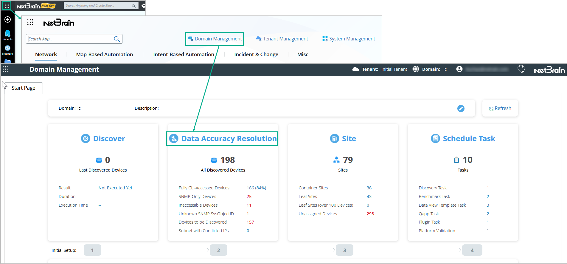

- Log in to Domain Management Page, and then click Data Accuracy Resolution on the Start Page.
- In the Data Accuracy Resolution tab, click All Discovered Devices on the left pane. All discovered devices are listed.
