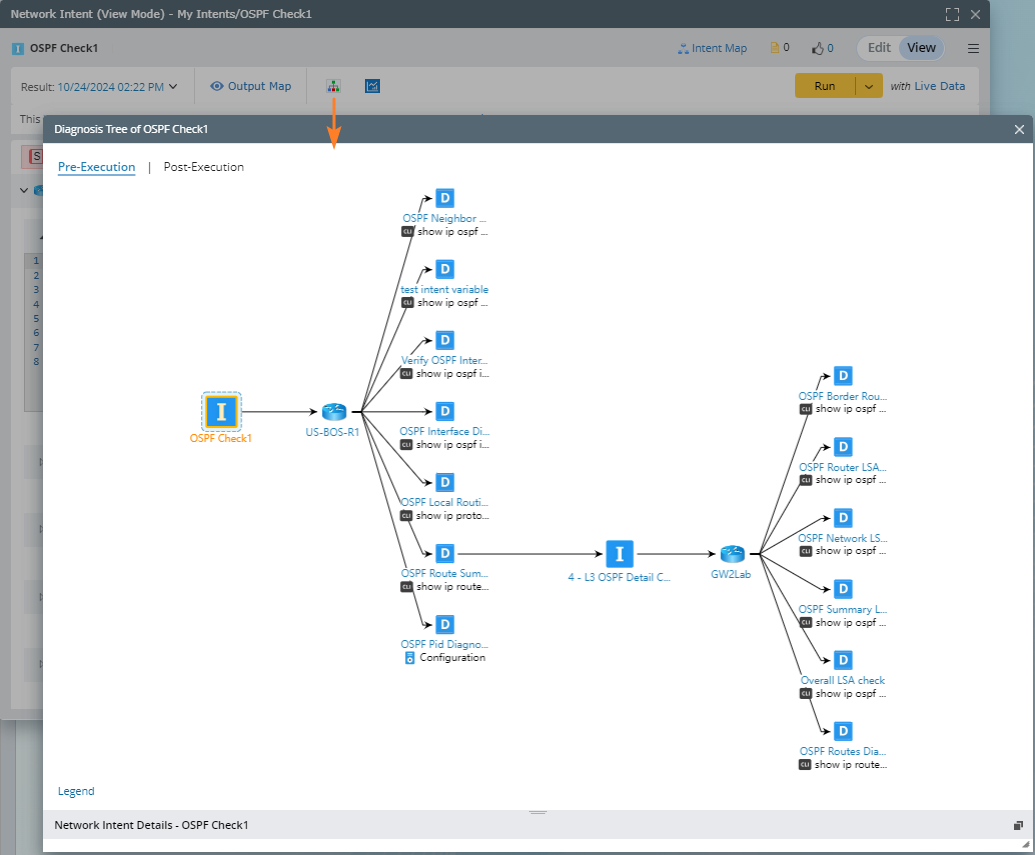

View Diagnosis Tree (Pre-Execution)
After Follow-up NIs are defined, you can browse the Diagnosis Tree (Pre-Execution) of home NI to view the entire multi-staging diagnosis design, which consists of :
- Home NI
- All NI Diagnosis
- All Follow-up Intents
Enter the NI Edit Mode and click the Diagnosis Tree icon to open it.
Note: You can only view the diagnosis tree in Pre-Execution mode before the Follow-up diagnosis is executed. |
Display Logic of the Diagnosis Tree (Pre-Execution)
The display logic of the Diagnosis Tree (Pre-Execution) is as follows:
- An NI can have multiple diagnoses, and each diagnosis generates a diagnosis node. These diagnosis nodes are always displayed regardless of whether the follow-up intent is defined in the diagnosis.
- Follow-up intents or Stop nodes defined in each diagnosis are displayed in parallel on different branches.
- You can drag the selected node and zoom in/out to view the tree.
