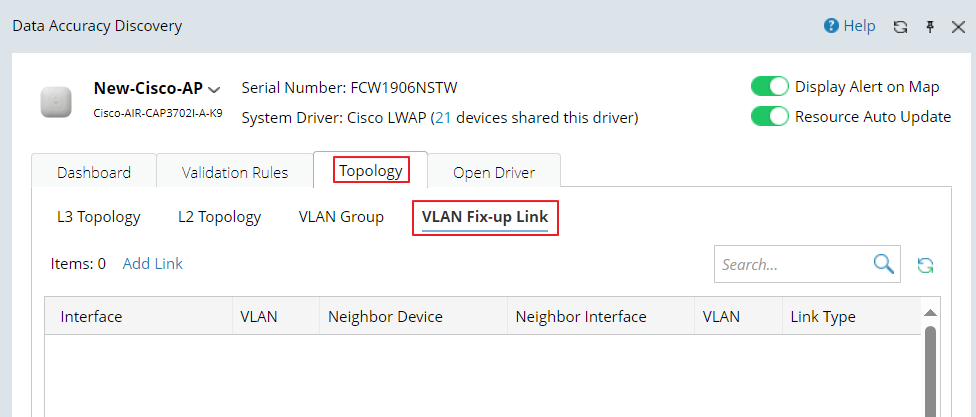

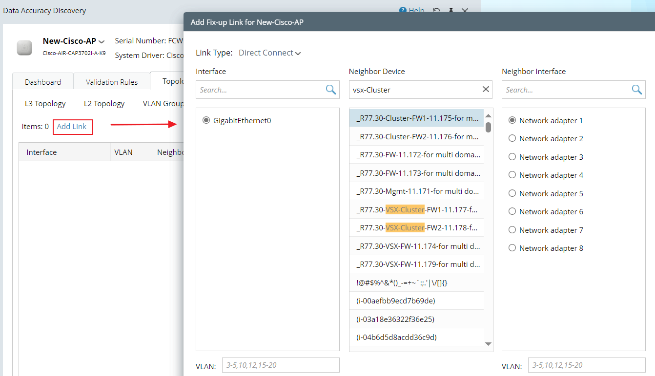

- On the Data Accuracy Discovery window, click the Topology tab and then click VLAN Fix-up Link.
- Click Add Link to open the window.

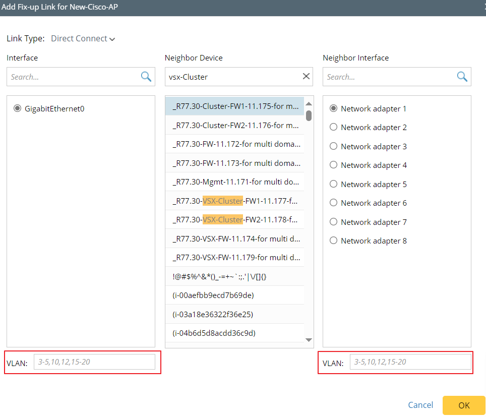

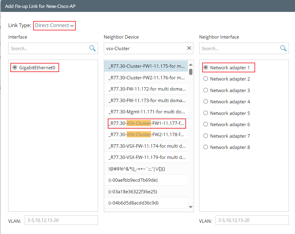

- Select the link type, then search and select the device interface and the neighbor interface to add the link.
There are two Link Types:
- Direct Connect will affect both the VLAN group and L2 topology
- Virtual Connect only affects the calculation of VLAN groups. The Virtual Connect is designed to support Overlay technology such as OTV and VxLAN.
Note: You will need to enter the interface VLANs for both sides of the link:
