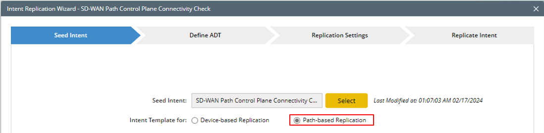

Define the ADT and Specify ADT Columns to Update Existing Column Group Using Path-based Intent as Data Source
Prerequisites: The selected seed intent (for example, the intent "SD-WAN Path Control Plane Connectivity Check (Viptela vEdge)") is configured to be a path-based intent template.

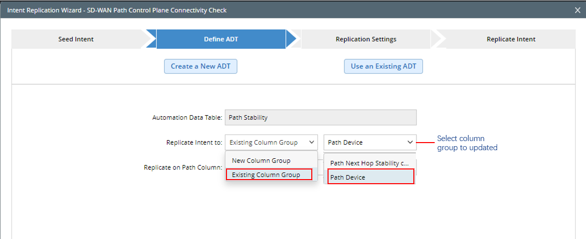

  2. Select an ADT (for example, "Path Stability") from the pop-up Select Automation Data Table dialog, then click OK to close the dialog. Then the selected ADT will be added to the Automation Data Table area.

  3. In the Replicate Intent to area, select Existing Column Group, then select a column group (for example, "Path Device").

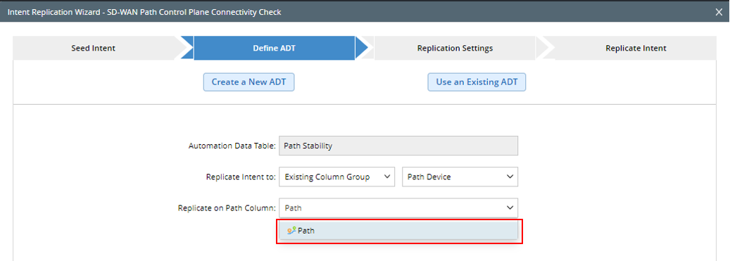

  4. In the Replicate on Path Column area, select the Path loaded from the column group or other path column to replicate intent using the path properties.

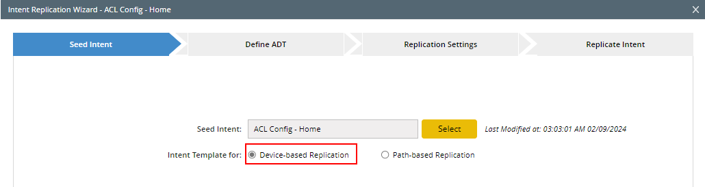

Define the ADT and Specify ADT Columns to Update Existing Column Group Using Device-based Intent as Data Source
Prerequisites: The selected seed intent (for example, the intent "ACL Config - Home") is configured to be a device-based intent template.

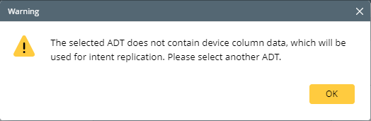

    Information Note: When the seed intent in intended to do device-based replication, it is required to select an existing ADT containing device column or device list column. Otherwise, an alert message will appear.
