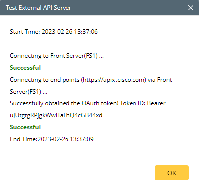

- Click Test to initiate a connectivity test between the NetBrain front server and the Cisco SNTC API configured.
| Test Results |
Screenshots |
| Successful Connection | |

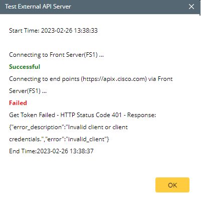

Error Scenario: The entered credentials are incorrect. Possible Resolution: Confirm credentials specified in the Cisco SNTC API Adaptor configuration and retry. |
