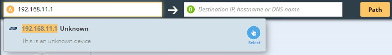

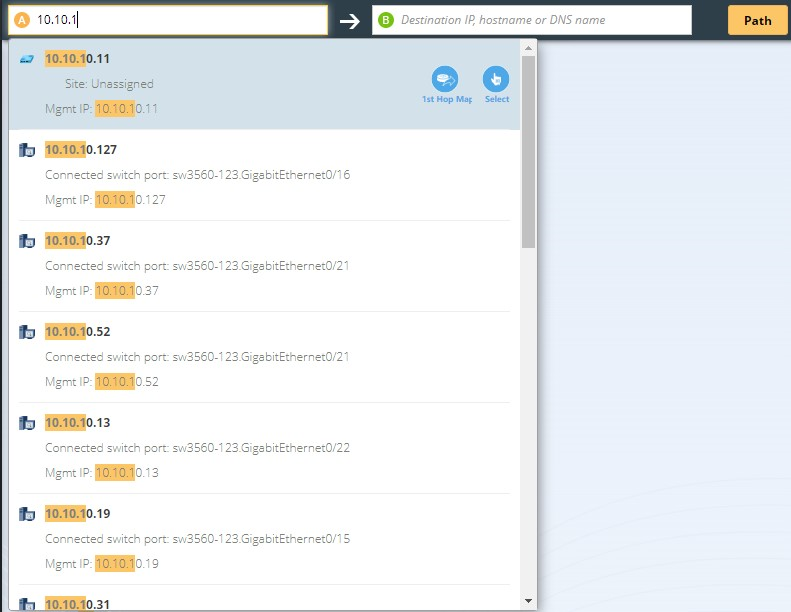

Display of IntelliSense when entering:
- IP address:
- Hostname:
- Unknown IP:

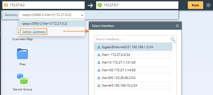

Select Not-Directly-Connected Device as Gateway for End system
During path calculation, you can select the interface of a not-directly-connected device as the gateway in the following case:
- The gateway calculated by path is not the one you want.
- You do not manage the gateway device.
You can select any device's L3 interface as the gateway for the end system. However, only the current device's interface with configured IP is supported to be the gateway for a network device.
