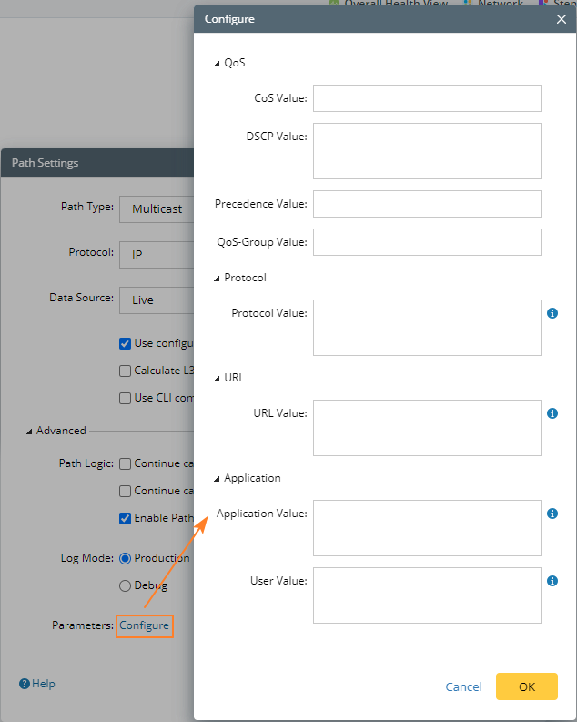

Parameters
The system cannot recognize and retrieve the first-hop information of an end system from a live network. Such as QoS information So, when the source device is an end system with QoS configured, you can specify the values of QoS parameters for the source device before calculating a path.
With the parameters configured, the system checks the ingress and egress QoS information at each hop and calculates the path based on QoS policies. The following figure is a sample QoS path:
Tip: The parameters displayed in the path settings can be predefined on the Domain Management page (Operations > Domain Settings > Path Parameters Settings). See Built-in QoS Parameters for more details. |
