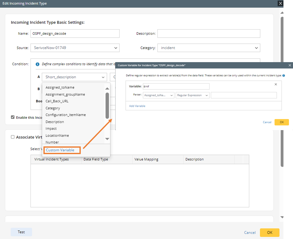

   To define a simple condition:
    1. Select a data field of the API call, for example, Short_description
      • You can also create a custom variable to retrieve the value from the data field by regular expression. The custom variable starts with $. For more information, see Custom Variable in TAF
    2. Select an operator (contains, does not contain, matches, does not match, is not null). For example, you can choose Contains
    3. Enter a keyword. For example, you can enter Interface error.
Apart from selecting existing data field, custom variable can be defined for an incident type in TAF to retrieve the value from the data field when conditions are defined for matching the API call with incident type in NetBrain.
In TAF, you can define custom variable as you define incoming incident type or define triggered diagnosis.
  • Define custom variable when create/edit incoming incident type.
  • Define custom variable when defining triggered automation.
Example: You can create a custom variable to retrieve the value from the data field by regular expression. The following example aims to get the device information (for example "Device: BJ-R1") from the description of the original ticket
  1. Click  of Condition A in the Condition section, then select Custom Variable.
  2. In the pop-up window, define the following:
    1. In the Variable field, type the variable name "$device" for the custom variable (note that the custom variable starts with $).
    2. In the Parser field, set to parse "Description" data by regular expression "^[^#]*Device: ([\S]*)$".
  3. Click OK. Then you will get the device variable value "BJ-R1".
