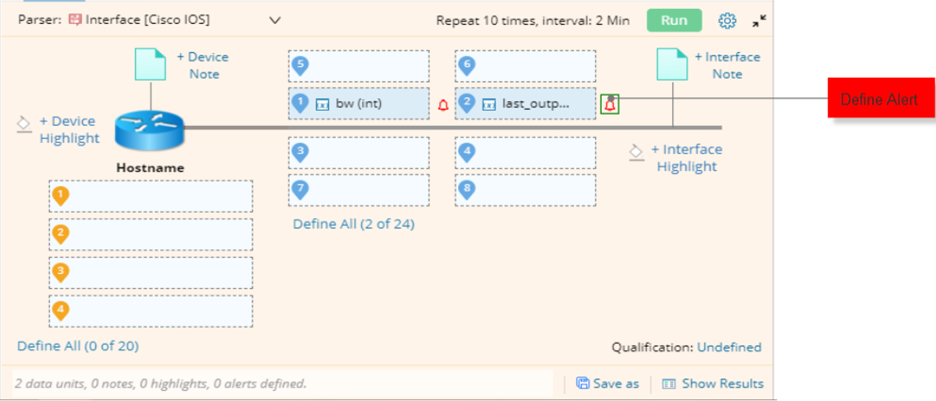

The entrances of defining alert:
Graphical user interface

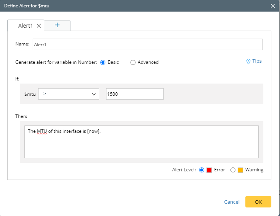

The Define Alert Dialog:

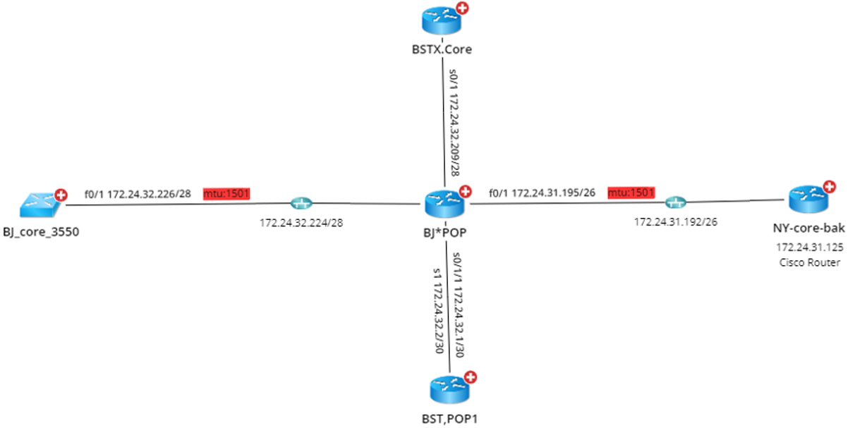

With the above alert definition, the “mtu” data unit shown on the map will be highlighted if the specified condition matched:

  • Provide different variable analysis operations according to different variable types.
  • Optimize the definition of condition in the ‘If’ statement to make it closer to natural language and easier to understand.
  • Support more methods for different types of variables in ‘Operation’ and expand the range of cases covered by the alert.
