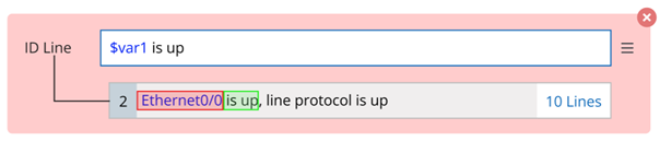

  • When one word is selected from one line as a variable (double-click the word in the parser input area), a typical line pattern is generated in the form “anchor + variable + anchor”. For example, in the sample data below, if 10.10.10.10 is selected as variable, the line pattern identifier $identifier, local will be generated.

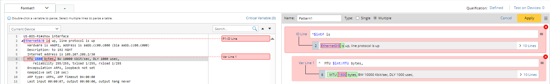

  • If a new selected variable is not in the same line with the existing variables, a new line pattern will be generated for the new variable. For example, in the sample data below, double-click “Ethernet0/0” to add line pattern “^$var1 is” first, then double-click “1500”, a new line pattern “^ MTU $int:MTU bytes,” will be generated.

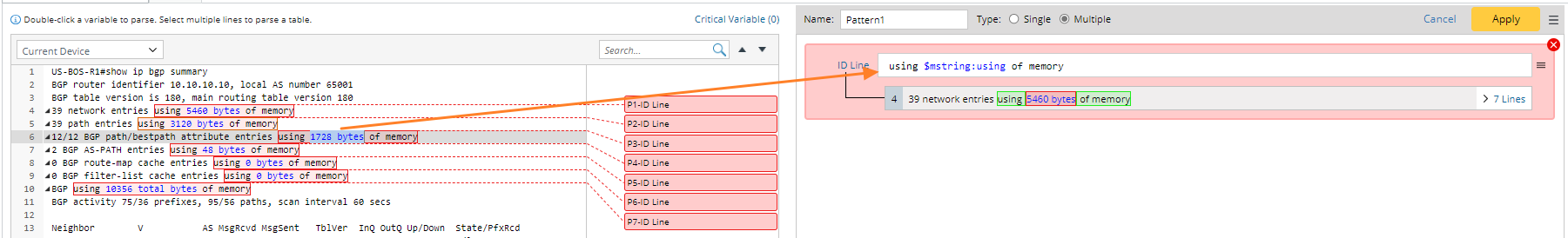

  • If several words are selected as a variable, the variable type will be automatically set to “$mstring”. For example, in the sample data below, if “1728 bytes” are selected as a variable, which are two distinct words, the line pattern “using $mstring: using of memory” will be generated.

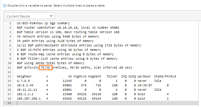

  • The words beside selected variable will be considered as anchor if they are “String” or “String + Special Character” type. For example, if the word “75/36” is selected as variable, the word “activity” at the left side is in string format, and word “prefixes” at the right side is in "string + special characters" format, so these two words can be set as anchor to identify the selected variable.

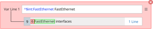

  • If no word before the selected word can be used as anchor, ^ will be added as anchor. For example, if 39 is selected, and there is no suitable anchor before it, ^ is added as the anchor. Line pattern ^$int:path path is generated.

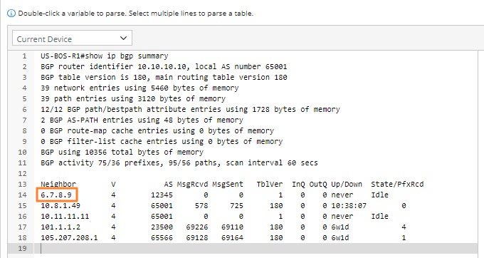

  • If the word before or after the selected word is of the types (“Number”, “String + Number”, “Number + Special Character”, or “String + Number + Character”), the system will skip this type of word ($_dummy will be used to replace these words) and continue to find anchor. For example, if 6.7.8.9 is selected, the line pattern “^$var2 $_dummy $_dummy $_dummy $_dummy $_dummy $_dummy $_dummy never” is generated.

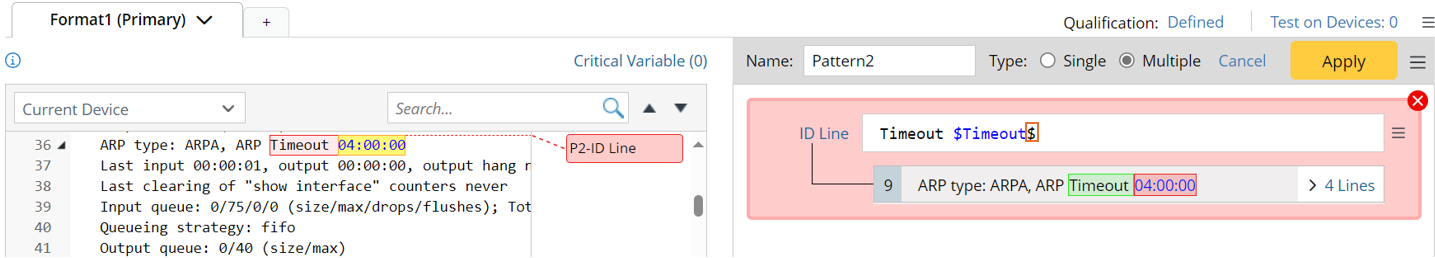

Take the following Paragraph Parser as an example: the parent line pattern only contains a variable of interface name (note that there is space before and after the variable).
  • To define the parent line pattern, you can use “^ $int: minute”, which means the variable starts with a space.
  • You can use $Timeout$ in the line pattern, where the second $ means the end of this line pattern.
