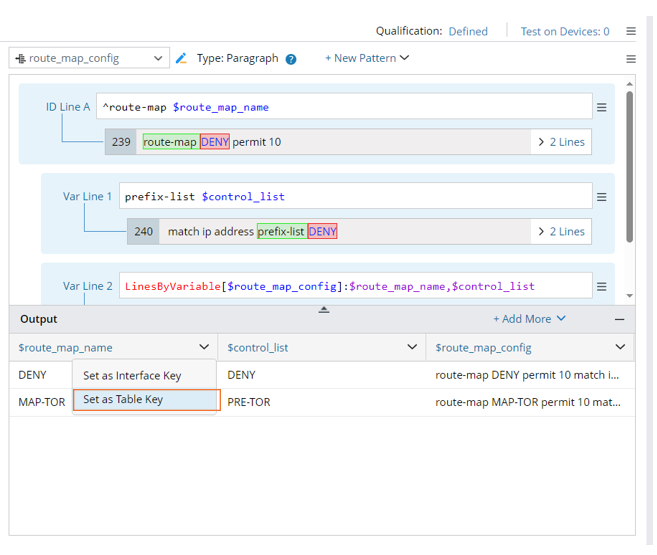

- Select a column in the output table to be set as interface key or table key. Click the
icon of the target column, then click Set as Table Key. in this example, the $route_map_name column is set as the table key. The values in this column will be used as reference for comparison.

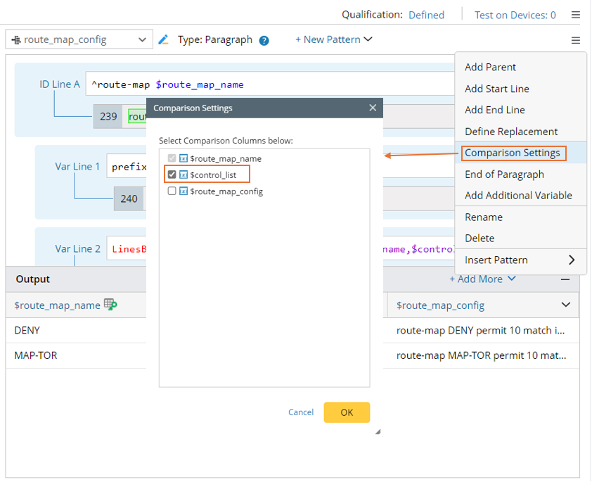

- Click the
icon, then select Comparison Settings from the dropdown menu. Check the checkbox to select columns to be compared. The column that is set as interface key or table key in step 1 will be selected by default.
- Click OK in the Comparison Settings window to close this window and save the settings.
