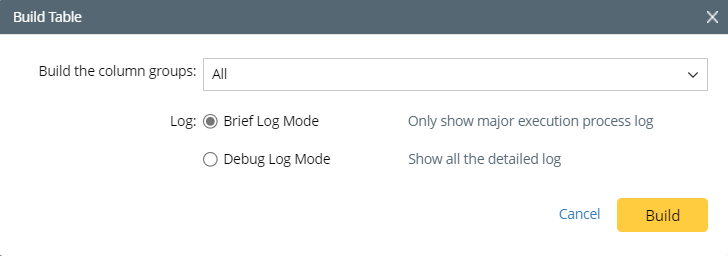

- Click Save and Build to save the settings and build the column group data.
Tip: If you click Save, the system will save the settings without building the column group data, and the Automation Data Table Builder will remain open.
