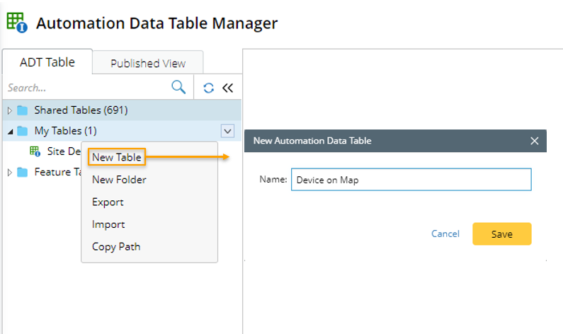

- Open Automation Data Table Manager, then create a new table and name it (for example, Device on Map).

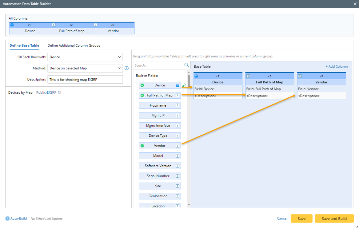

- Click Table Builder to open Automation Data Table Builder of the created ADT.

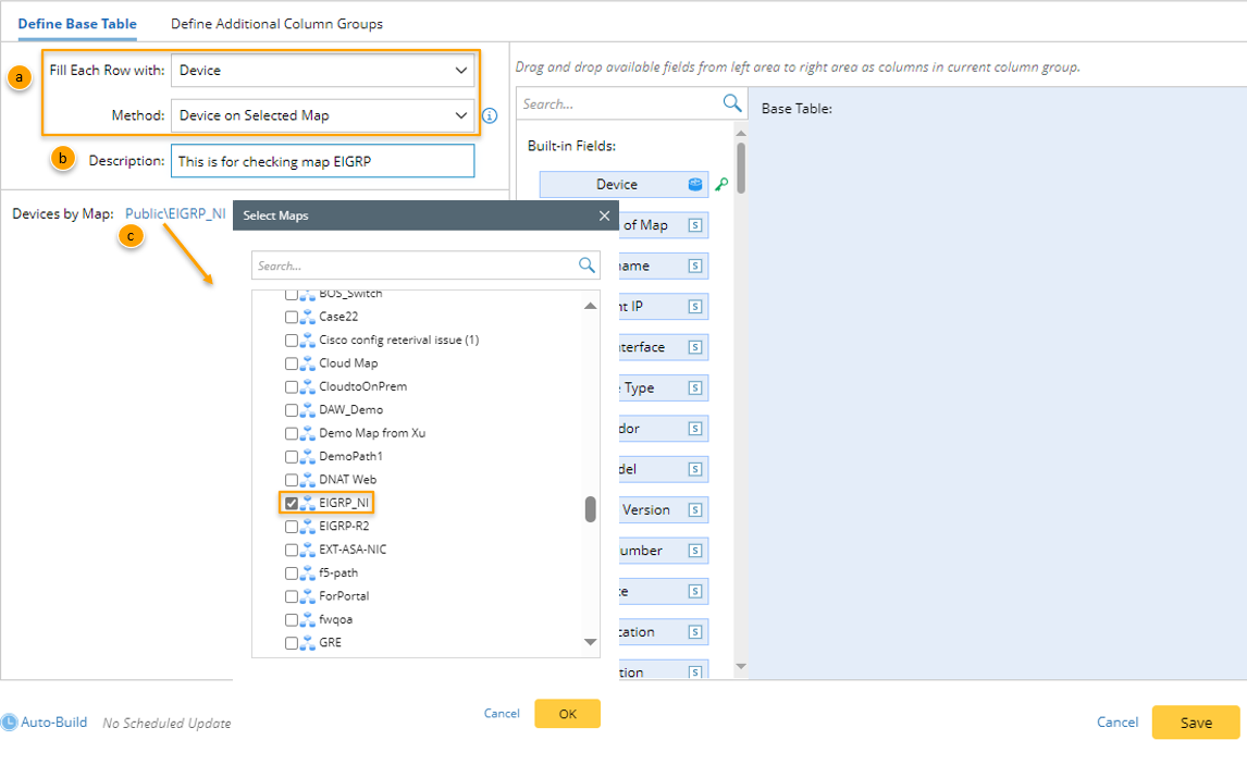

- Under the Define Base Table tab of the Automation Data Table Builder, define the following settings:
- Select Method to Build Base Table: Select Device > Devices on Selected Map. After this method is selected, the available fields (which can be selected in step 4) will be listed in the Built-in Fields area.
- Description: Input descriptions for the base table (for example, This is for checking map EIGRP) to describe its use and function.
- Devices by Map: Select the created map (for example, device group named EIGRP_NI) for building the base table with the devices on the map.
- Mapping Available Fields to Column Group: Drag and drop the available fields (for instance, Device, Device Type) to the column group definition area to create ADT columns automatically. For the Device on Selected Map method, Device field is the key field.
