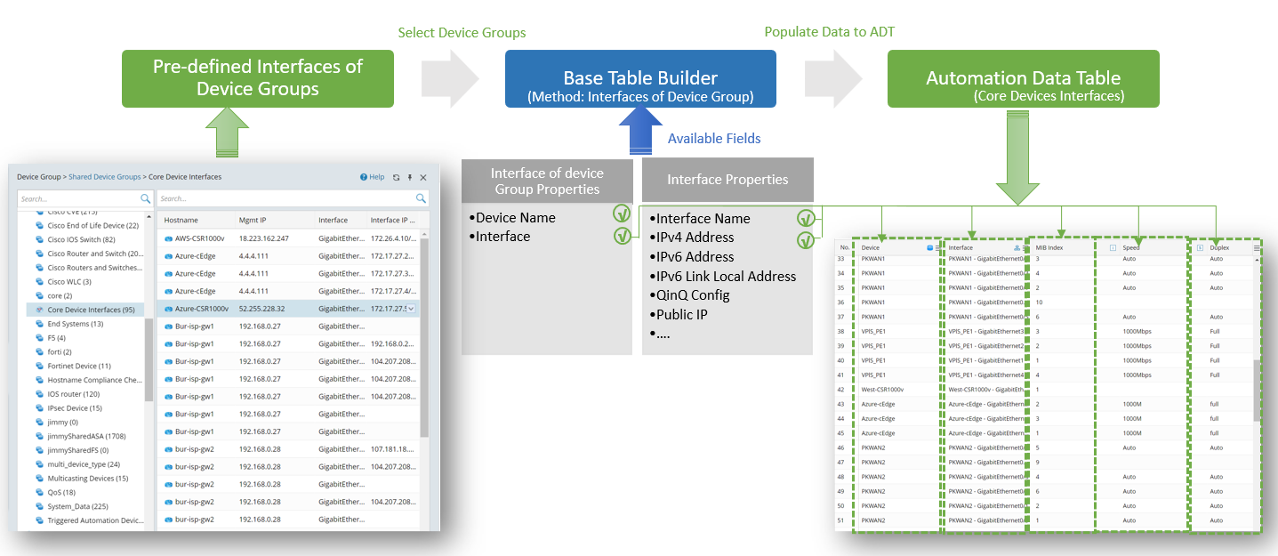

ADT can be built via the Interfaces of Device Group/Map when certain device data/map data and interface data in pre-defined link groups within the domain are used to troubleshoot specific network issues. This enables the display of relevant data (e.g., the device interface) and the association of troubleshooting intents with the device interface.
Define Base Table via Device Interface of Device Group
The interface of device group is used as an input, and the device, interface and interface properties will be used as input data for filling the table rows. Device and Interfaces can be used as built-in data.

    1. Select Method to Build Base Table: Select Device Interface > Device Interface in Device Group.
    2. Description: Input descriptions for the base table to describe its use and function.
    3. Device Interfaces by Device Group: Select the created device groups containing device interface properties for building the base table with the devices and Interfaces in the device group.
      Information Note: Only link groups are displayed as options, while device groups without device interface are automatically excluded from the Select Device Groups dialog
  4. Mapping Available Fields to Column Group: Drag and drop the available fields (for instance, Device, Interface, etc) to the column group definition area to create ADT columns automatically.
