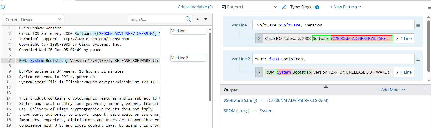

After selecting one or more words from the sample text, and only one variable value is parsed, you will enter single pattern mode. And the line pattern generated from the selected variable will be added as Var line. The output is one line for each single variable. The current mode is called Temporary-edit mode (in red background).
  • As the var lines are modified, the matched lines for the line pattern and the final output in the output area change accordingly.

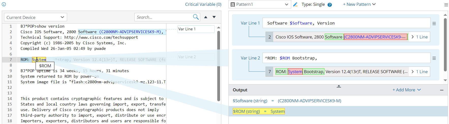

  • Double-click the variable in the left input area, the searchlight in red color appears to locate the corresponding line pattern and output.

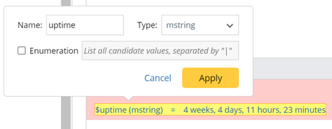

  • Click the variable in the matched line area or output area, a floating tip window will appear, and you can edit the variable name, variable type and define enumeration.
