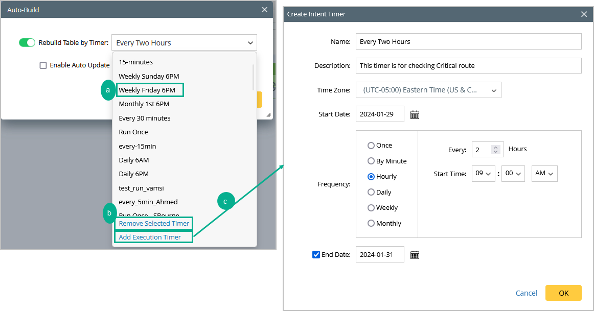

From Base tab or Group tab in the Automation Data Table Builder, click Auto-Build.
- In the pop-up Auto-Build dialog, choose any one of the options from the following list:
- Turn on Rebuild Table by Timer, then select a proper Timer available in the system.
- You can remove the selected timer by clicking Remove Selected Timer.
- If the existing Timers cannot meet requirement, you can set up a new timer. Click Add Execution Timer and set up a Timer in the dialog. Then click OK, and the created Timer can be selected for automatically building ADT data.
- You can Auto update after building the contents of ADT:
- Select the Enable Update Intent Dashboard checkbox.
- Click Select and then select a dashboard from the Select Dashboards window.
- Click OK in the Auto-Build dialog to set up Auto-Build.

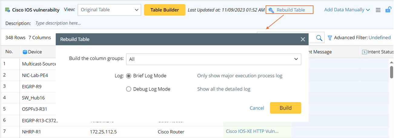

To manually update table data, click Rebuild Table from an open ADT.
By default, all the column data will be rebuilt, however, you can specify some of the columns in ADT for rebuilding table data by configuring Rebuild Table Settings, which will speed the data rebuilding process (for more information, see Select Column Groups for Building/Rebuilding ADT Data).

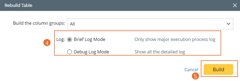

When you click Rebuild Table, the Build Table dialog appears. You need to define settings as per your preferences. After defining setting, click Build, you will see
when the table data rebuilding is in progress. The last time of rebuilding table data (Last Updated at:) is displayed after the process is completed.

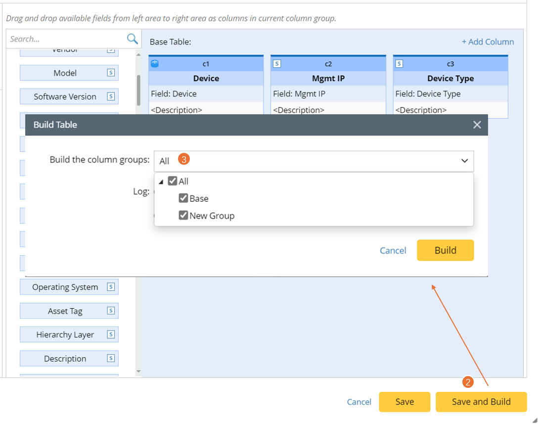

- Open Table Builder of an ADT.
- After defining column groups, click the Save and Build button.
- In the Build Table Settings dialog, select column groups for building ADT data. By default, all column groups are selected.
Note: User must select at least one column group to build ADT data. An error message will prompt the user if no column group is selected.
- In the Log section, select a log mode.
- Click Build to apply all the settings and build ADT data.

placed before the Rebuild Table button. - In the Rebuild Table Settings dialog, select column groups for manually rebuilding ADT data. By default, all column groups are selected.
- Click Build, the rebuild table settings will be applied during the process of rebuilding table data.
