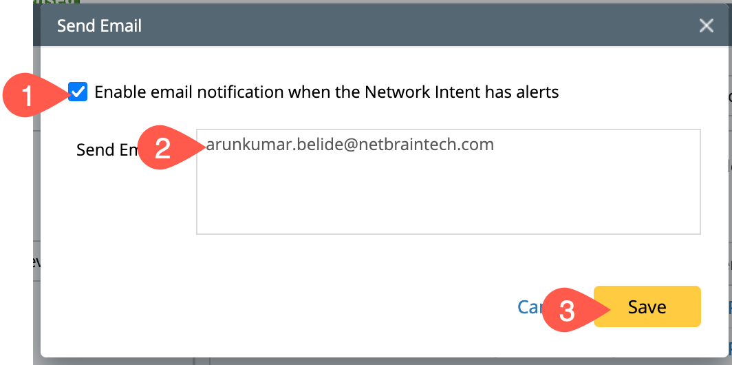

Setting the Email Alert:
Set up an email alert with a predefined Trigger Event Template whenever the NI has alerts as follows:
  1. Check the box to Enable email notification when the Network Intent has alerts.
  2. Type in all the email addresses separated with a semicolon (;) in the field Send Email To.
  3. Click on Save to save and close the Send Email pop-up window.
